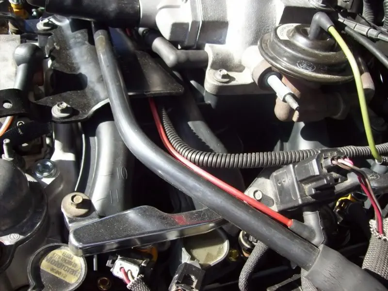

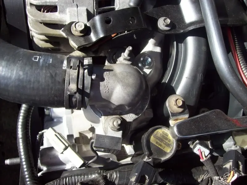

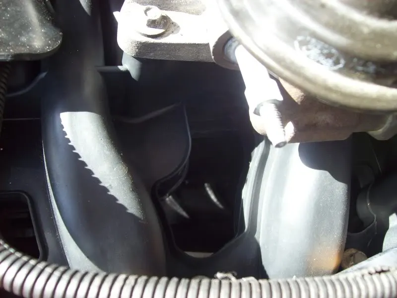

noticed today when i was swapping the new spark plugs today that the runners on my new intake manifold looked funny..then i noticed cutouts in between the runners that i could see the valley of the motor through.. thought it was odd so i took some pics...i think my installer effed up and got me an NPI intake mani...please tell me im wrong...but the car also feels like its lacking on power also.. not the best pics but here they are

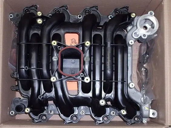

i googled pics of NPI intakes and found this one on a crown vic forum and it looks identical to mine
please tell me im wrong...please? would an NPI intake mani even bolt up to PI heads without some kind of kit?

I doubt it is an NPI. The water jackets are different. That is why you have to seal the PI intake on NPI heads when swapping. The only way I could think of, was if they used NPI gaskets. Even then, I don't think it would work. I might be wrong, though. Hope the motor is ok.

i just found out by doing more googling its the dorman PI intake manifold which as you can tell by the smaller runners is a crappy smaller version of the ford intake mani meaning reduced flow and i might as well have a NPI on there
