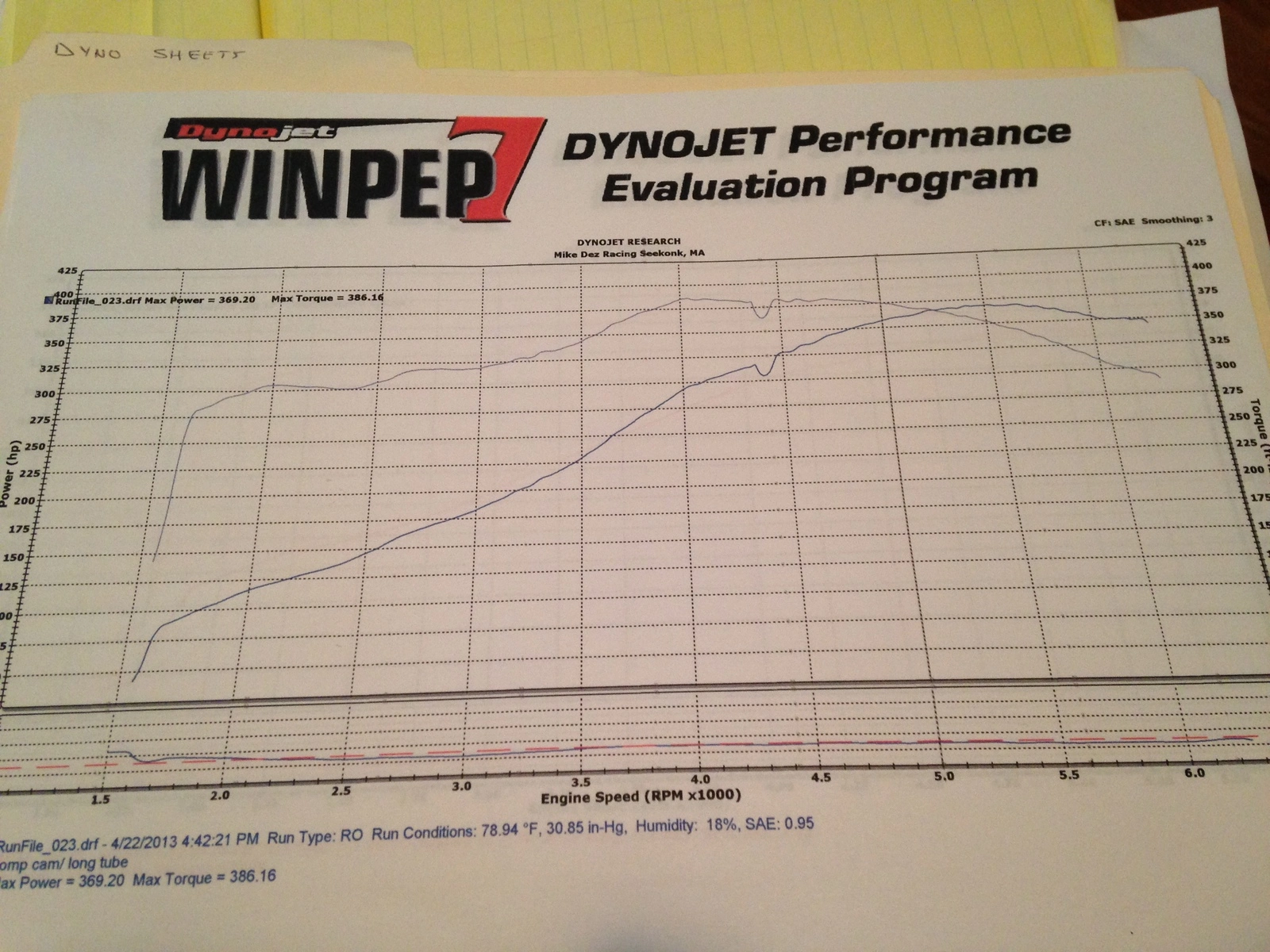

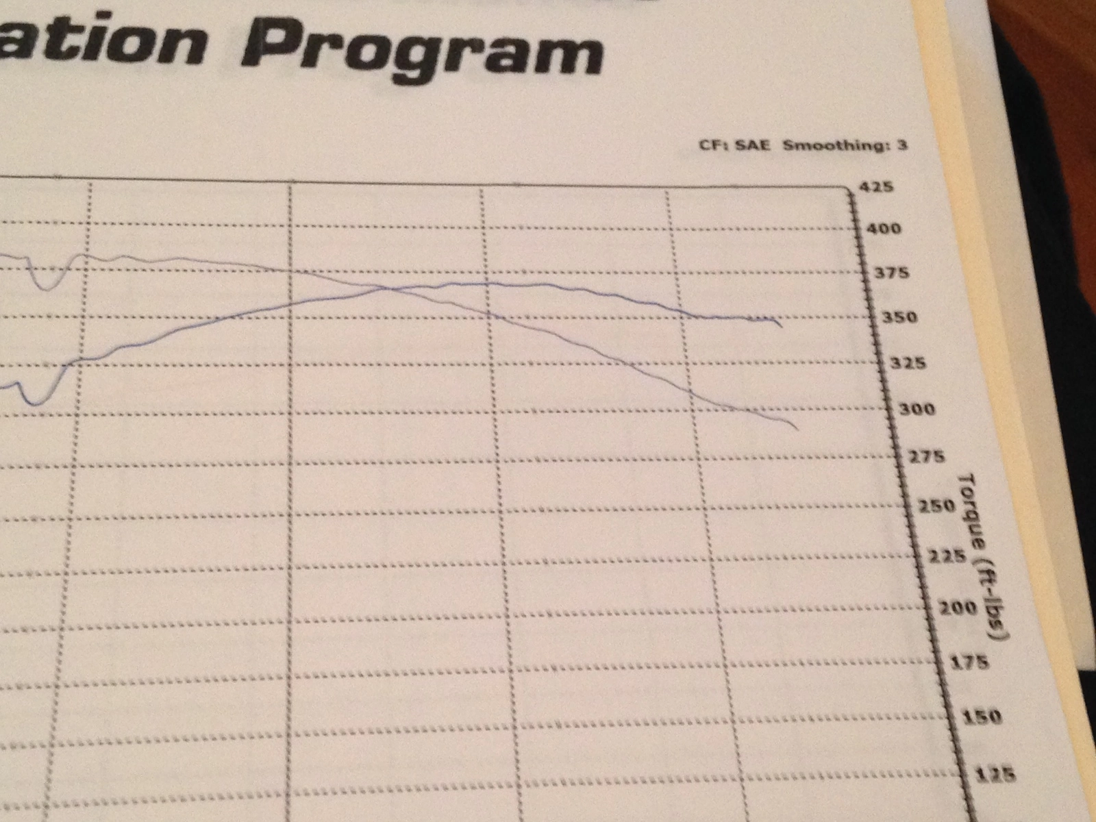

here is my dyno sheet, i believe i can pivk up more hp and a few rpm from an intake upgrade. What do you all think?
Parts list looks good. I wouldn't change a thing. Practice Practice Practice. A 1.60 60' isn't out of the question if you can get it to leave. That should shave almost a second off your et where you stand right now! Once you get the driving down pat, Nitrous ftw!
I always used to get my best 60ft times out of my Mickey Thompson ET Street Radials when they were at near stock tire pressure. Don't think I ever dropped them below 22psi...and generally ran them around 28psi.
