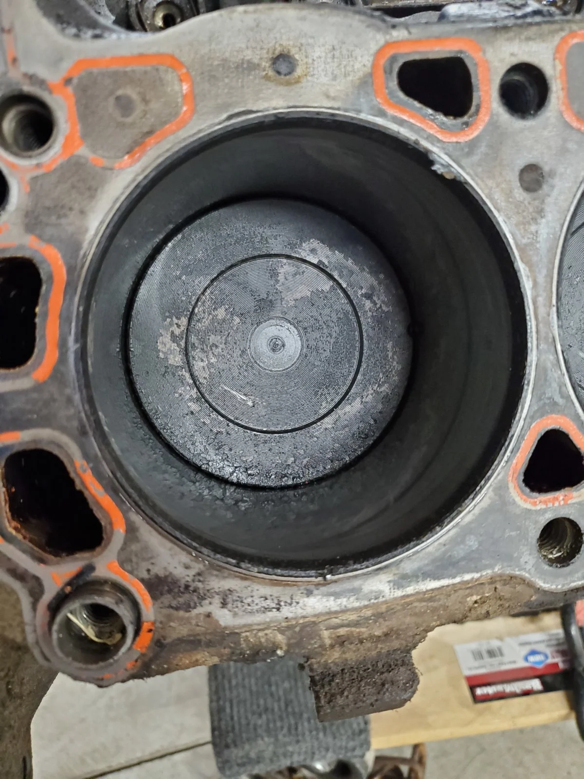

So, I bought the block. Got it for hella cheap with new arp head bolts, a full gasket set, plus everything the guy had new for this. Anyhow, digging it apart to see how bad she is, realized after popping the heads they are e6se heads and dished/flat pistons. Any thought of what this came out of?

1986 Mustang probably
That would be odd with a 1988 stamp on it.

The heads are 1986

JMGlasgow said:
The heads are 1986
Gotcha there.
But didnt the pistons in 88 have valve reliefs?

I think so. My 1988 block does.

E6 heads were used on the non-HO engines after 1986. There’s a date code cast into each head just like the block, and I bet they are 1988 dated.
That engine likely came out of a 1988 non-HO car such as a town car, or a thunderbird.
I'll check it out.
