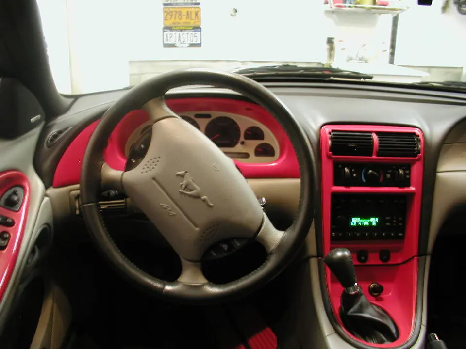

So, has many you know, my interior has been painted red by the previous owner :bang:.
My interior is black top with gray. Yes, in the picture, it looks tan, but it's not.
I think my stock interior should look like this. But I'm not sure. What do you think? Can anyone post their interior that matches my interior?
Now I have to find replacement parts fo rthe interior. Where can I find these parts? Obviously from Ford Dealership but they cost $$$.
Oh, BTW, I finished repaint the red hoodscoop and side scoop girlls back to black :banana:

It will, do not use paint thinner or any kind of nail polish remover with acitone in it. I would try to get them repainted or maybe look on Ebay for some replacements. Good luck that looks horrible, but at least you're trying to fix what some terrible person did.

do this and it will look pimp. take each part u have. sand it down with 220 grit sandpaper. do not use any that is rougher than that. when u have it down to bare plastic, take 1000 grit sandpaper and wet sand each peice. then wet sand it with 2000 grit sandpaper. 1000,and 2000 grit sandpapers can be found at a local auto parts store. now when ur done sanding with 2000 grit it sound be smooth as hell. take some car polish preferably the ones that reduce swirls and use it a couple times. it should come out to look good or very shiny but retain its natural color. u don't have to use a clear coat if u sand it good to have a high gloss shine.

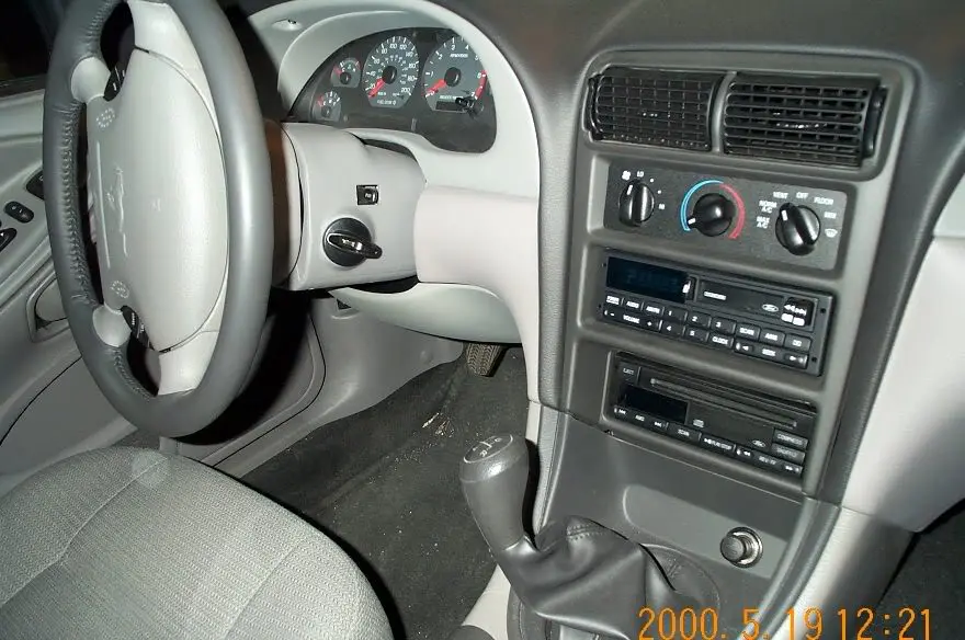

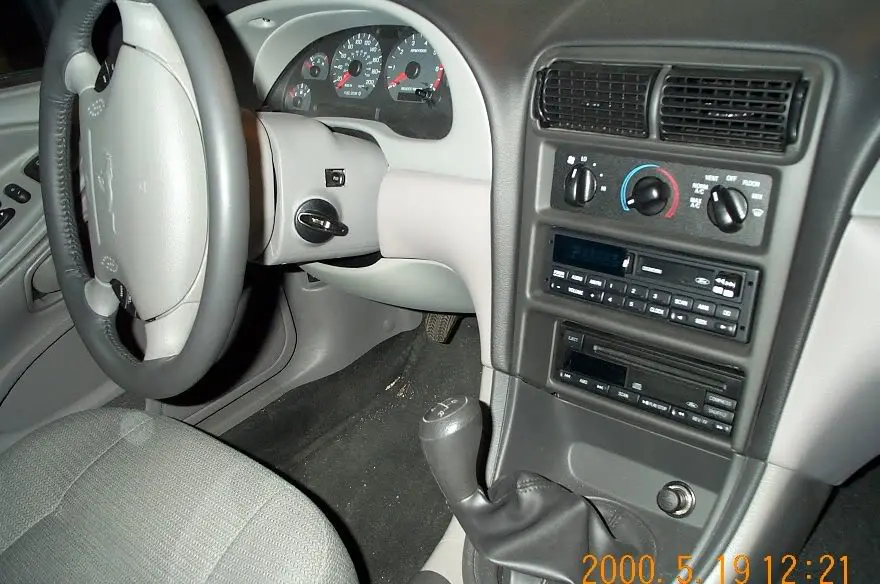

I have that same interior... minus the red/pink bs. Those parts are the same color as the dash, or outer portion of the steering wheel. Original it looks awsome, one of the best two tone interiors I've ever seen. I'll see if I can get a pic posted after work tonight, it really does look good.

If I'm not mistaken, aren't the 99's a little different from the 01's?
99:
01:
Or is that just a difference with the in dash changer package?
My 99 looks like the above listed 99, but his matches the other:
I like the way it looks (not the red one), I may get one like that and relocate my switches...

Ever consider a light media blast to get rid of the old paint. Something that’s not so abrasive maybe, like walnut shell? :shrug: You’ll likely still have to repaint it after that, since if the previous owner prepped it properly before painting, he should have scuffed it up a little to make the paint stick…and you’ll have to do the same. But at the very least you wouldn’t have to worry about it flaking off and that god awful colour showing up underneath.
Ok, first, why do you guys all think that the paint thinner will harm the plastic? I have spent some time working with plastics and paint (i worked at Fisher-Price and painted lots of stuff) and if I messed up on something and needed to strip the paint off, I would use thinner. I guess you would need to know what kind of paint it is on there, but I have never seen plastics harmed from thinner. I would start with the door cups/handles as those are really easy to come by and are cheap to replace. Take one of those and use paint thinner, then after you have spent forever rubbing all of it off, get some buffing compound and go to town buffing it. Stuff should come out like stock. If it doesn't work, then you really haven't lost much. You could also try using Bestine to remove it. Bestine does a really good job removing glues and paints. Good luck.

I used thinner on mine to clean up some spots where hair got on, it melted the plastic.
