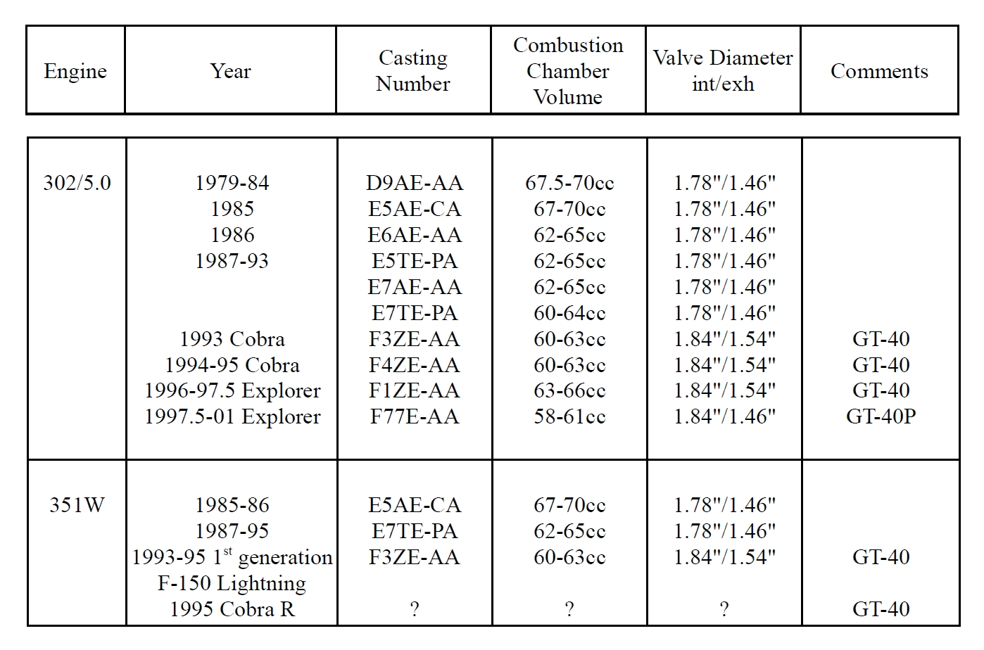

So how does what I found fit into my plan? Should I just massage the E7 heads a bit now (or scrounge for some GT40's) and install some inexpensive Tri-Y's headers? I have a friend who will give me some GT40P heads but I've read about header problems.

If it's already apart and someone is willing to give you P heads that are in useable condition, I would use them. Just get headers that are made to work with the P heads. They're out there. If everything else is matched and tuned good, the P heads should get you 40hp additional over the E7's.
Holy crap, 40hp over stock? The heads are sitting on a shelf. That should easily get me to my HP goals then :) The last engine build I researched was a mild 460 for my old truck...i spend a couple weekends porting out D1VE heads and was grateful for any additional HP gains it netted me, lol.
GT40p also have a smaller combustion chamber than the E7. So that results in a slight bump in compression ratio too. Always good for a few extra ponies. GT40p valves are larger than E7 too
