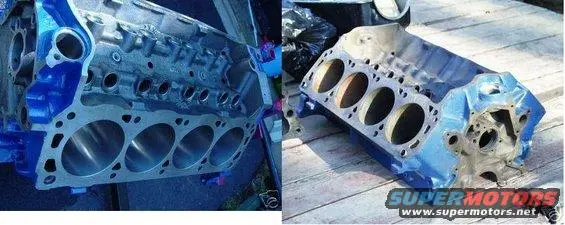

it sounds like a 351w. as i recall those were the last years for that engine in the fullsize fords. look on either side of the distributor near the top bolts that secure the timing cover. if you see a reinforcing rid that runs from the bolt to the top of the block, then you definately have a 351w. no rib it is a 302.
..................302 block.........................................................................351w block
