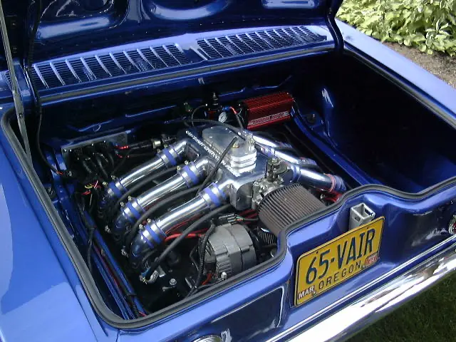

Clamato (it will not let me put Camaro) style intakes like the one pictured, but the six spider legs will be not be wrapped under. They go out to stand on to the heads.

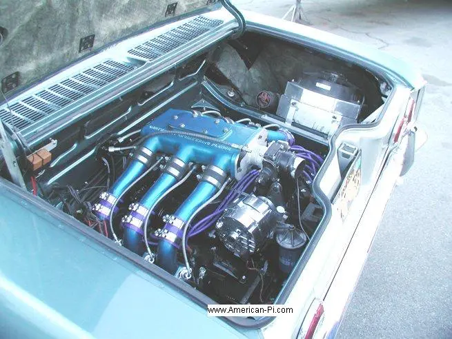

So unless I end up with icing problems, the cool air flowing over a center plenum on the way to the center cooling fan will not be a bad thing. (Pics of two cool ones included.)
