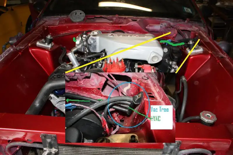

Ok here we go....
Follow the green line... it comes out of where your ac goes in the fire wall... and goes to the vac tree shown with the expanded box.

Adam95GT said:
Ok here we go....
That's where I've been looking for a few days now. The hose looks great going into the vacuum tree. I will follow it and see if it shows anything else. Thanks for everything so far!

WOW - It was right in front of my eyes the whole time. The smallest hole you could imagine in the line. Thanks for everything. This got me thinking about some things though. Not too long ago I made a post about exhaust coming through my vents. Could a hole (or multiple holes) in the vac lines allow exhaust from the engine bay into the vents?
