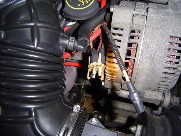

But you know the rubber plug on the passenger side where the red, green, white, pink? vacuume lines plug into? Heres a pic, not my car.
I unplugged it and passed propane directly at both ends and nothing happend to my idle??? AND If i unplug it and blow into the female end I hear air escaping which sounds like its down in my inner passenger fender...is this normal?
ALSO...my egr is capped off and the vaccume line is still running to it could that be effecting anything?

That vacuum manifold is for the EGR actuation and TAB and TAD IIRC. If you have no EGR function or Smog function, I guess those are no biggie.
Do ensure the source lines feeding the slaves (inside the passenger fender. Remove the wheel liner to look at them) are not still hooked to manifold vac or you could have a leak when the solenoids open).

There are vacuum lines (with manifold vacuum) going to the emissions solenoids in the fender. If the lines leaving the solenoids and going to the various components are not connected, you end up with an air leak when the solenoids open (instead of actuating a device, the line is just sucking air).
If you disconnect the 'feed' lines (supplying manifold vac) to the solenoids, or disable the solenoids, this should keep the leak from occurring.

maifold vaccume gauge I dont see why mine wouldnt be hooked up? sorry man im tired mabye im just being a dumbass and not understanding you?
