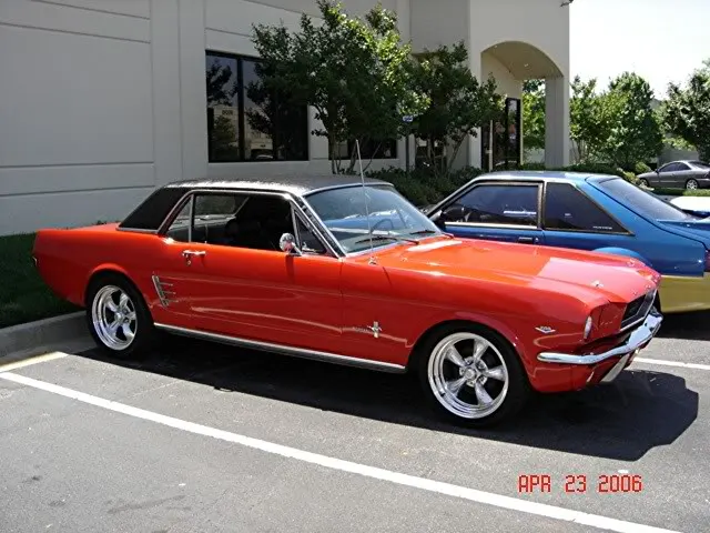

This photo was taken the day after John painted it. Never looked as good. I cut the stock coils and used the opentracker rear leaf mod to get that stance, no lowering blocks. Those are the ever so popular 17x8 toqur thrust IIs with 4.75 bs and 245/40zr17 tires all around. No rubbing, not even when turning and hit a bump or dip. Fender lips tightly rolled.

uhhhh...I have 245 40 17 on the front. I have a road course supension and alignment setup on the car. In pic one the car is at full launch on the drag strip and you are seeing my blistering 1 - 2 inches of lift ;) Pic 2 shows how the car sits during standard driving conditions
If I put a less agreesive alignment on the front the tops would be much closer to the lips of the fender. Here are better 'everyday' shots
It looks like I'll be going with the 4.75 bs then if it allows the larger tires... your setup looks about as close to perfect as I could hope to get.
