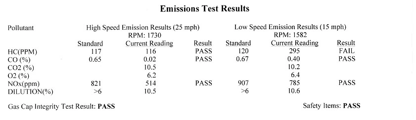

I failed my emmisions test on my stang. Can yall give me some suggestions as to how to fix this problem. Also the guy said he thinks my car is misfiring at low rpm's. I have only 15 days to fix the problem and take it back or im out the money. I attached the results of the emmision test just incase that can help yall tell me what to do. Thanks in advance.

Hmmm, for some reason i am not seeing the attachment. I'll just type in the only part that im failing.
LOW SPEED EMMISION RESULT (15mph)
RPM 1582
Standard Current Reading Result
HC(PPM) 120 295 FAIL
This is the only portion that i failed.
By the way this is a Texas inspection.

I got a print out of possible things that might be wrong from the guys i went to, maybe this will help?
Low CO and High HC- Check the Fallowing
a. Air Fuel Mis\xture too lean
b. Electrical Misfires (check ign system with scope)
c. Vac leaks (hoses, choke pull-off carb base, PB unit etc)
d. egr at idle
e. too much spark advance
f. closed loop operation
g. low idle speed
h. low psi on efi cars
i. air injection system
j. cat going bad
l. internal engine problems (low compresion, leaking exhuast valves/valve guides or rings)
