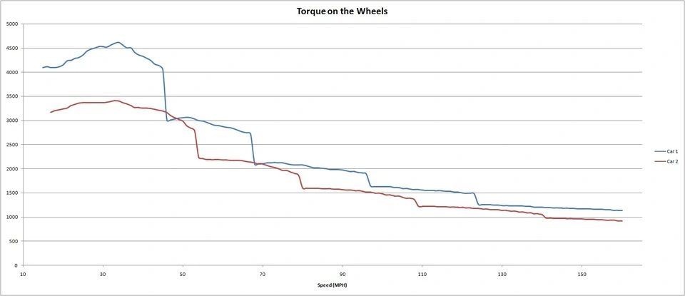

I've actually got a racing calculator built in Excel that includes all the gearing stuff. After entering your constants (rear gear, transmission gear, and tire height), you can calculate either the speed at an RPM or the RPM at a speed.
You can also enter your torque data from the dyno chart, gearing info, and shift points, and it'll graph the torque on the wheels (which is exactly correlated to how 'fast' your car is). Plus, you can do this with two different vehicles, making it easy to compare two vehicles.
For example, here's the graph of the torque on the wheels of a new Boss 302 vs. a Terminator (Boss in blue).
And you can see why a new Boss runs better than the Terminators do....
If anyone wants that calculator, PM me your email and I'll send it to you (unless someone knows how to post it up here).
