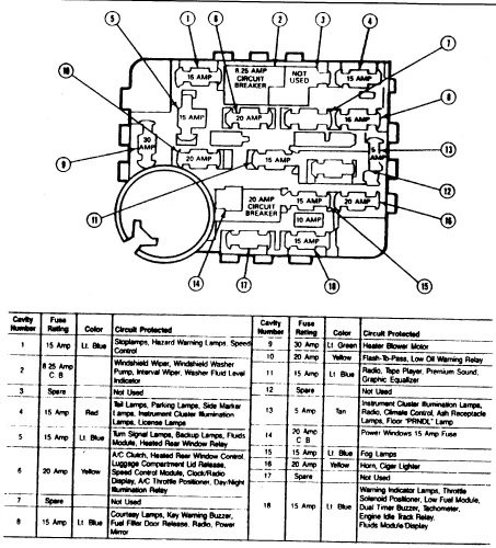

check fuse # 18 on the 94 the #18 fuse is for ccrm,ign power,icm,charging system,regulator signal..
