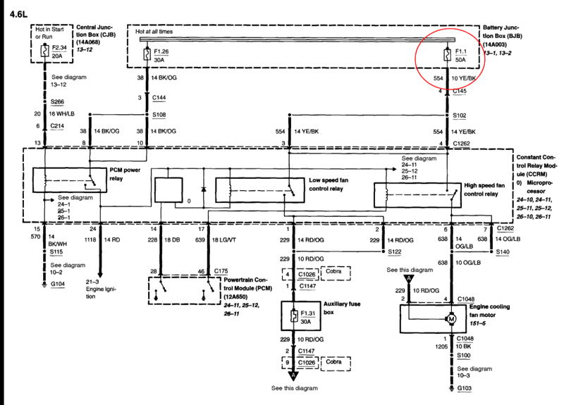

What size was the fuse that you checked out? If I'm not mistaken there is a 50 amp fuse that the fan runs off from as well, like the one shown below in the diagram. Not those small 20 or 30 amp fuses. My son's 2003 GT Mustang 50 amp fuse for the fan circuit kept blowing, the one shown in the diagram below circled in red. We cleaned out the fan wiring connecter contacts, and installed a 50 amp breaker in place of the fuse. So far, so good, and that was a couple years ago. Hope this helps. Good luck, Tommy.

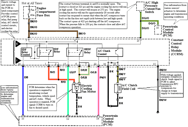

Here is what I just found. If the fan relay(s) are not located inside the battery fuse box, it may be designed inside the Constant Control Relay Module, like it is for the 94-95 GT Mustang shown in the diagram below. This is a multi relay module that Ford uses for various systems which sometimes includes the fan cooling system. Not sure where your Constant Control Relay Module is located. For my son's 2003 GT Mustang, it is located between the passenger side fender and fender well just above and forward of the strut housing. You need to find out where yours is located and try to get info on how you can test the fan relay portion of the module. Or take a chance by replacing it and see what happens. I have a feeling that your problem is within this relay module. Let us know what you find. Good luck, Tommy.
