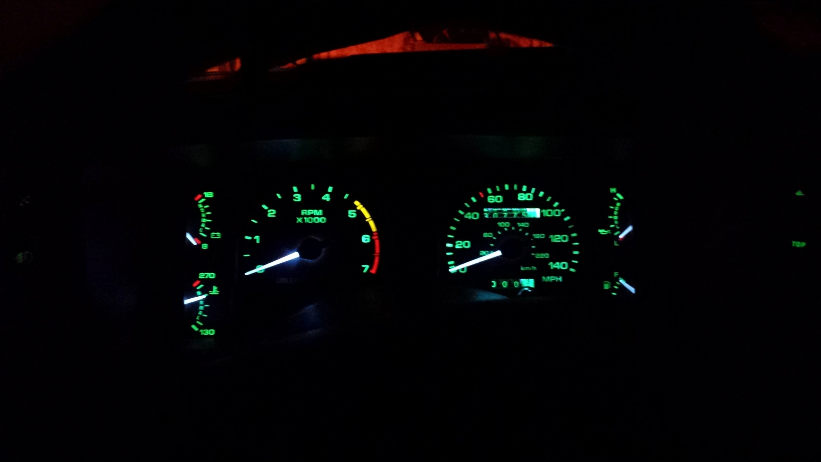

changed my cluster panel bulbs to LED. followed directions online and left the battery bulb OEM. onot problem is airbag light is staying on. Any ideas? my battery did die yesterday and I had to recharge - could that be why?
dash going back together... just taking out bulb.changed my cluster panel bulbs to LED. followed directions online and left the battery bulb OEM. onot problem is airbag light is staying on. Any ideas? my battery did die yesterday and I had to recharge - could that be why?
so did I. don't know what the deal is. When you turn the key over, which all lights illuninate? right now, mint shows check engine for a few seconds then turns off. Also I believe low cool and for a split second then off. I thought when you turn key to accessory, all bulbs light up then off to show they are working. I have a single LED in both turn signals and 5 - LED for illumination. everything else is OEM bulbs (checked they were all working). Don't know what the deal is but I took airbag bulb out. I have to say the dash looks great. initially I had LED bulbs in every section other than battery then realized that was silly and put most back to OEM like I said. This was really a pain in the ass though. I had the dash apart twice. I spent about 8 hours all together. stupid speedo cable didn't help. A lot of time was spent troubleshooting why some LED bulbs wouldn't work at first even when I switched polarity. I think there were some bad contacts. I finally got it all working. wondering why though the low oil, low coolant, etc doesn't light up initially when I turn key to accessory. wondering if the LED bulbs are messing something up drawing too much current??I left all the dummy lamps stock and just changed the illumination bulbs behind the gauges.
