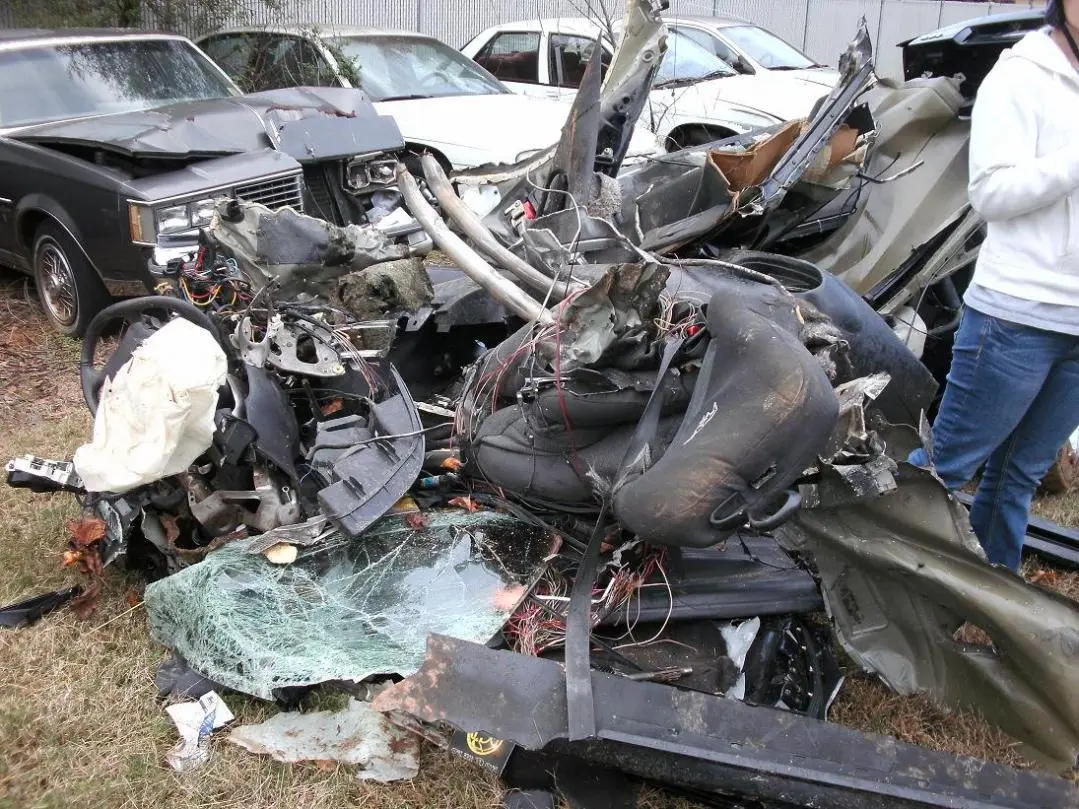

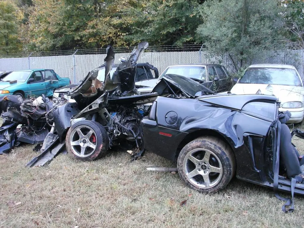

125+mph is what the troopers report said, its my brothers 00gt that he was killed in last october. so quit being a dumbass and drive like you got sense before you fall too man. come on:mad: heres some pics to maybe see that speed and street cars dont mix.
