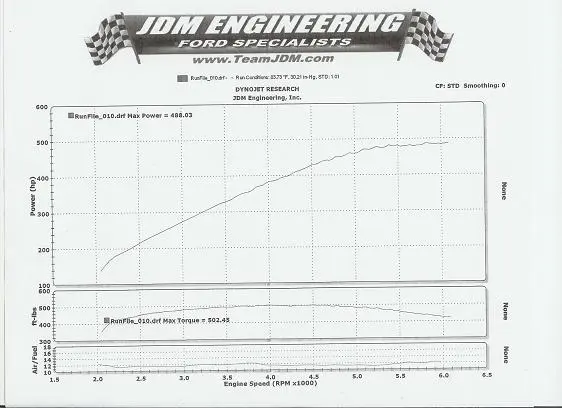

hey yellowjacketgt i have 488rwhp and 502 rwtq and i ran 12.073@117mph launching at 2500rpmand shifting at 6100.i see cobra's with similiar power running 11.40 @121 mph.i think we should be launching little bit harder and shifting around 6500

here it is
