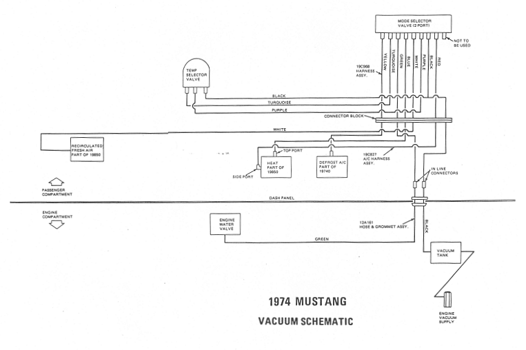

diagram
This is for a -74. It is probably different from year to year. Anyway, you might be able to get an idea of how to draw the hoses. Hope it helps you out!
