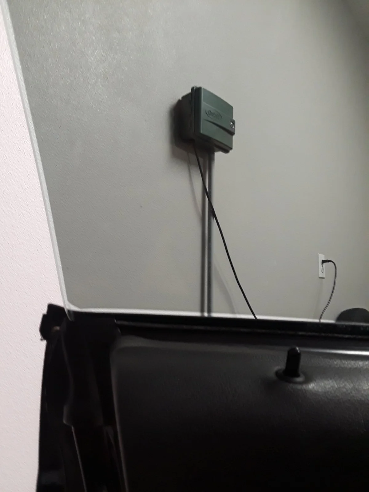

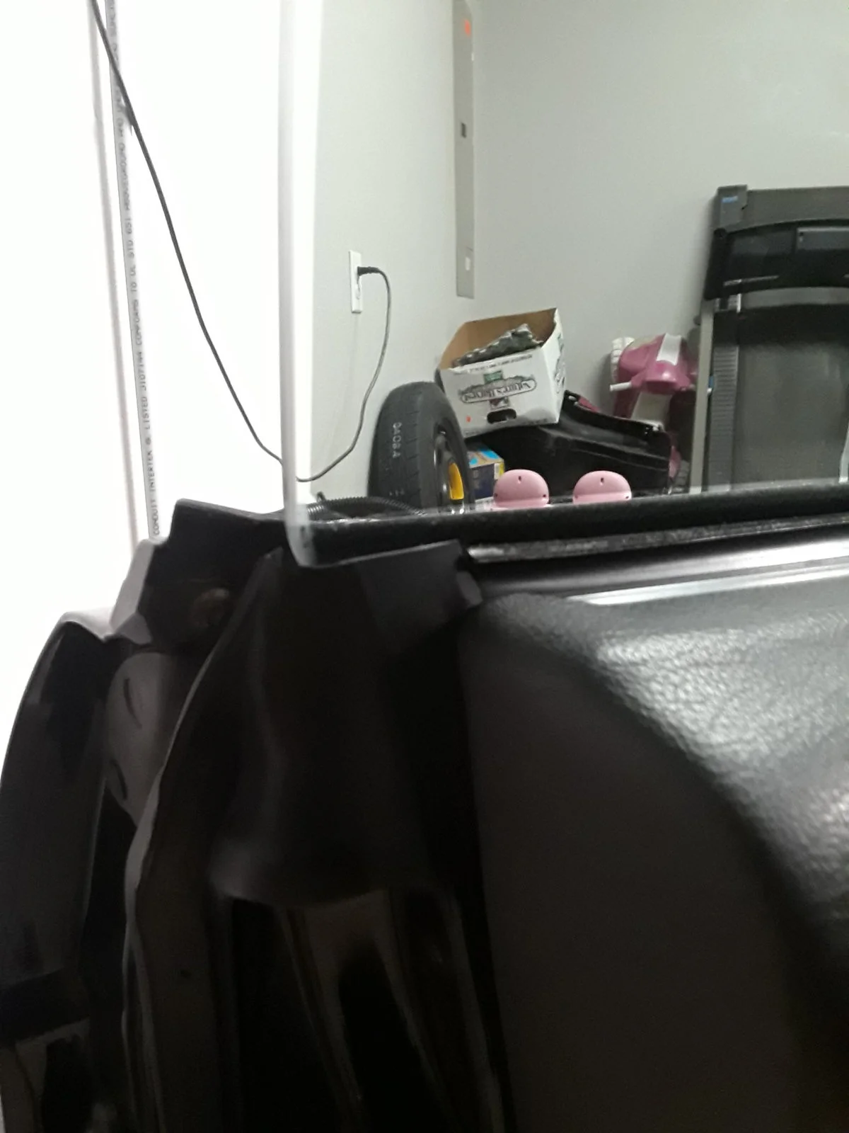

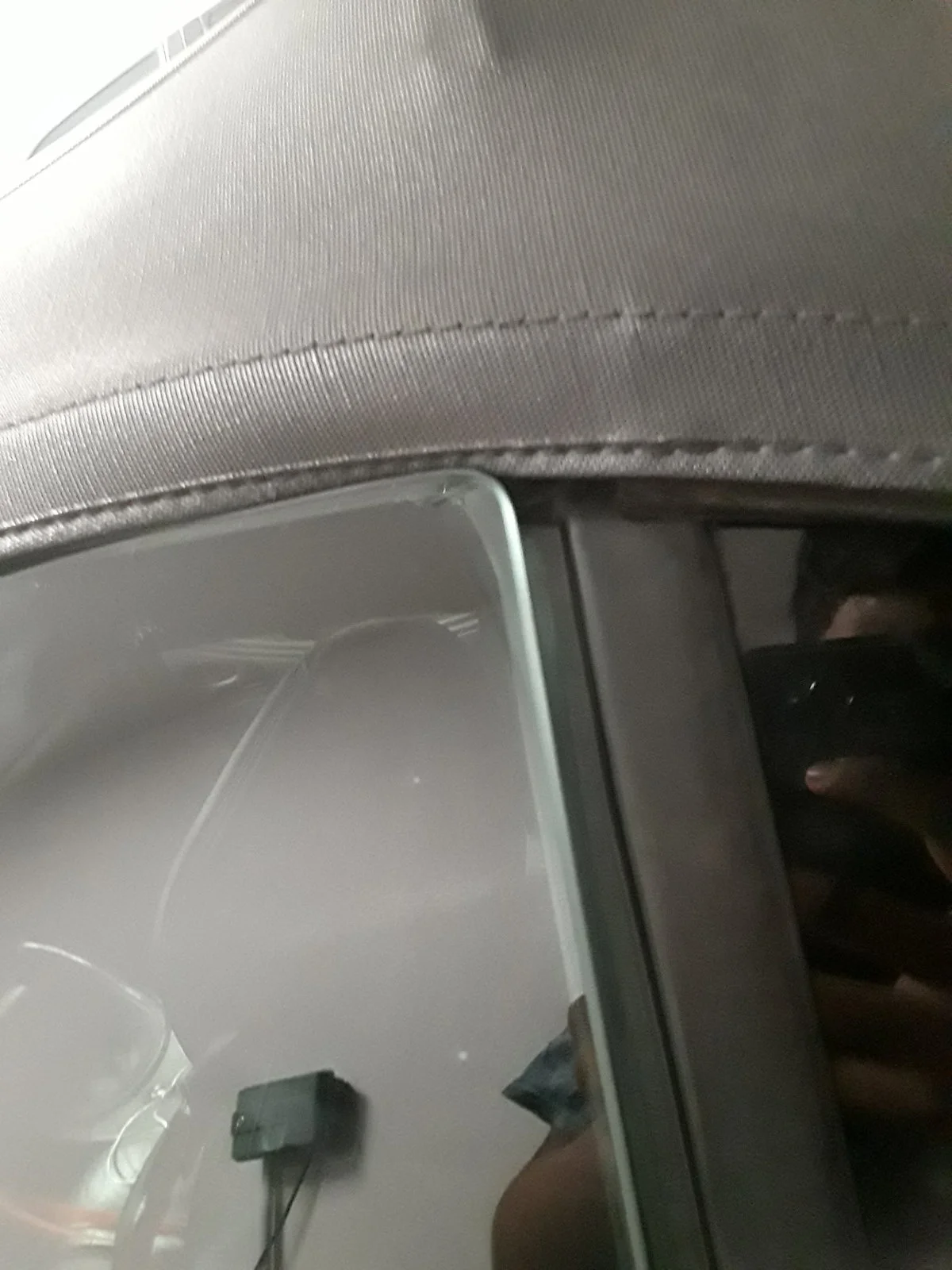

The window on my driver side is going to far up to the point were you can see the tint end. The window continues to catch on the convertible and will not close my door any suggestions? I've heard of the door motor going out is this what Is happing

I would pull off the panel and inspect the guides/stops and motor operation, if the other side is OK you could compare the two looking for discrepancies.

agreed, there are stops in the door to limit window travel. sometimes the plastic wedges on the window come off and have to be glued back into place. the wedges are what the stops rest against.
