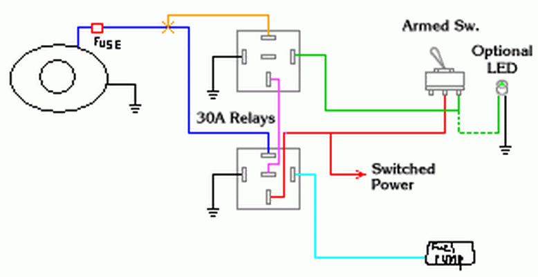

I'm trying to wire up my electric water pump to automatically turn on with the car, and when the car is off.. it will turn on if i hit my ashtray switch.
My car is all in pieces so i cant just do it and test it.
I called mezuirres hotline just to ask where a good key on wire was and he suggested the power wire to the fuel pump relay.
so heres my diagram that i made up and plan to do so far.
the lower right is the fuel pump relay key on wire, and of course the left is the water pump itself
my only question is will tieing the blue and orange wire together cause a problem with the relays?
I thought about tying the green wire right into the light blue to only use one relay to make it simpler, but that would turn on my fuel pump also im pretty sure
