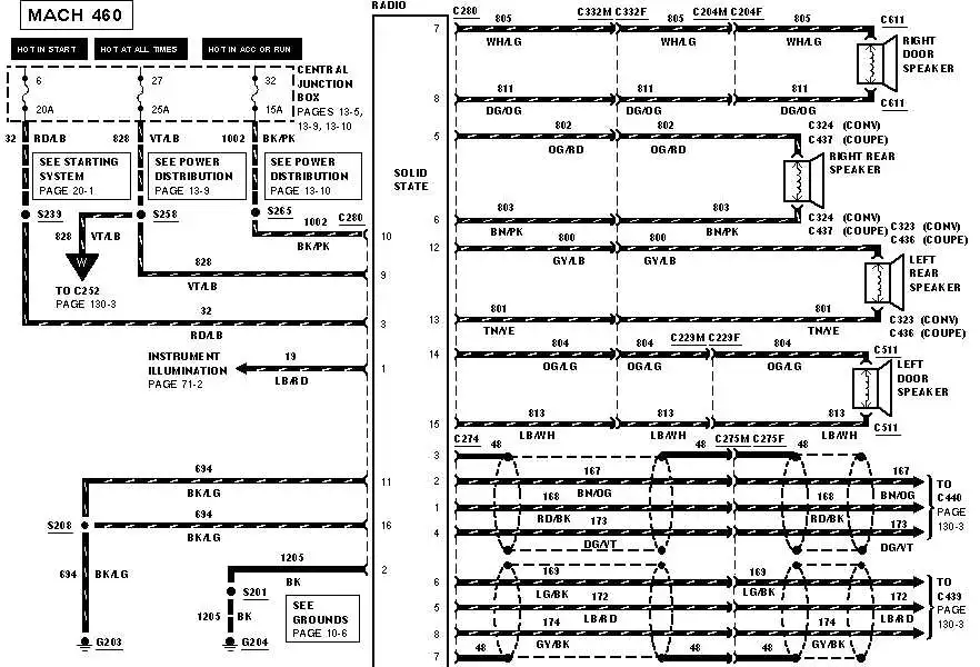

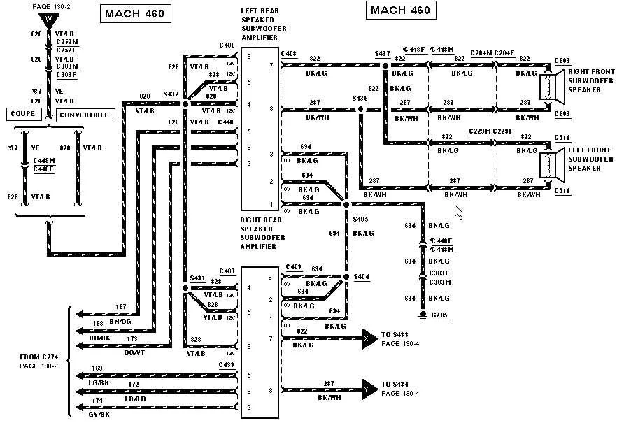

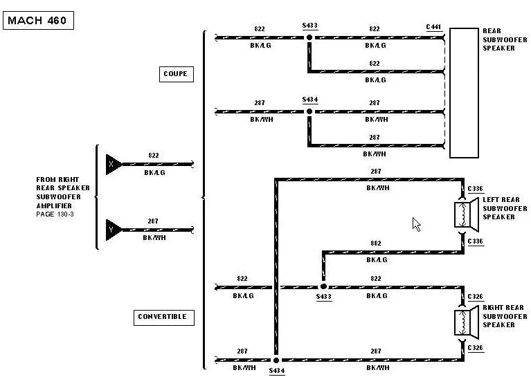

Is it possible to take the rear wires that lead into the rear amps of a 460 system and feed them to an after market amp to drive two 10" subs?
Or can I tap into the pre-amped signal and feed it to another aftermarket powered amp that is capable of driving two 10"s?
Is this even recommened if it can be done :shrug: or is it just a stupid idea :rolleyes:

So which wires do I tap?

Thanks for looking 4U2NV. Hopefully someone will know. I just don't want to go splice crazy trying to find the correct signal wires.

I plan on powering the amp from the batt., I just want to know where I can tap for a pre-amped speaker signal so I don't have to run wires to the back of the head unit.
1TRIKGT said:
the wires you need to hook up to are before the amp that lead to the head unit, it can be a pain Iv done it before
Thanks, for the info.:nice: Are there actually 4 speakers in the rear deck or is that wire diagram I posted just totally confusing?:shrug:
