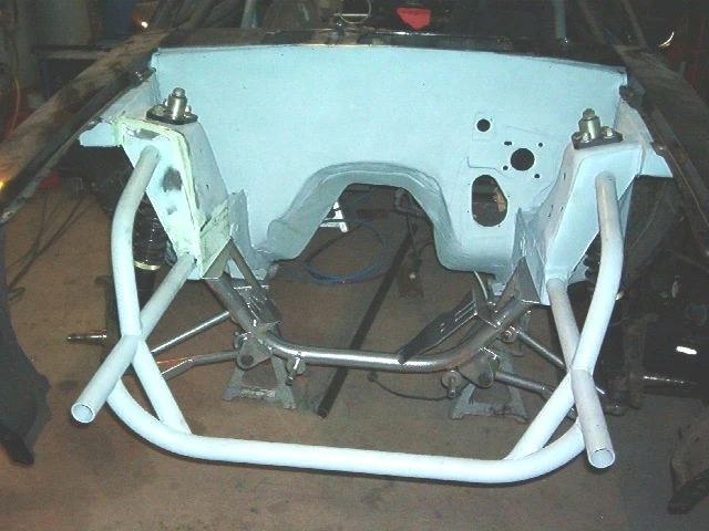

I'm doin that conversion also. Buyin the FMS kit. As far as mounts, im in a position to use motor plates instead. Which i prolly will. I have a C-6 for now but I heard a rumor that there is a clearance issue in the tunnel??? Anyone know for sure? If not, I'll find out soon when I set the motor/tranny in to test fit. Just waiting for my pan.
I think i have more than enuff room for the engine though ;)
