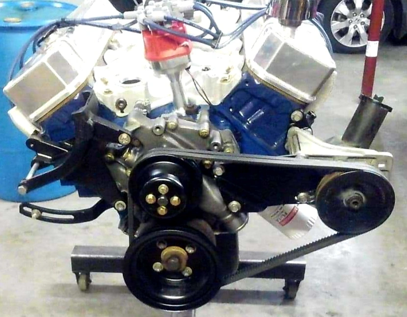

It's going to have it challenges for sure
2 buddies of mine that are brothers did this back around 1991. They had a 1990 and a 1991. One was a GT and one an LX and one was hit in front and one in the rear. They cut them in 1/2 and welded them back together and dropped a stock 460 in it from a 1970ish big car. can't think it if was a Lincoln or what but it was a big car. At the time they said you could not put a 460 in one with the stock hood, factory air conditioning and power brakes and they did all 3. Car looked 100% stock. It ran something like 11.70's but I think they had a small shot of NOS on it then. The one brother owns a body shop now and the other works at an automotive paint supply store. They re-made the k-member to drop the engine 2" to fit it under the hood and they modified the brake pedal mechanism to move the booster over a few inches to clear the valve covers. Back around 1993 there was a picture of it in Hot Rod magazine while on the Power Tour. Unfortunately about 5 years ago Lee was on his way back from the local drag strip running M&H's and it started raining. He ended up flipping the car. He still has it but they pulled the powertrain and put it in about a 1983ish Mustang the Lees son drives now.
Reactions: 1978_Mustang_II
Is that a carb or fuel injected manifold? Either way, I like it. Hydroboost is a must, but all the swaps I would personally consider (Godzilla, Coyote) would need that anyway.

Edelbrock dual plane with a 750 Quickfuel.
$500 is a good deal. I paid more than that just for pistons.
I’m sure the 750 delivers plenty of gas. With some heads and a cam to go with the Edelbrock, I’m sure the torque is bonkers. Carbs are just voodoo to me and this dog is too old for new tricks.
