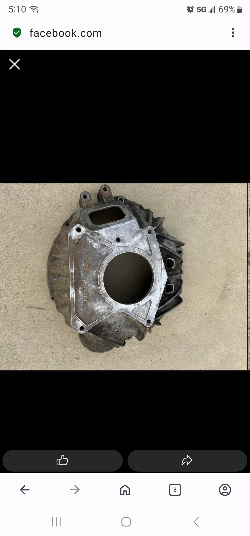

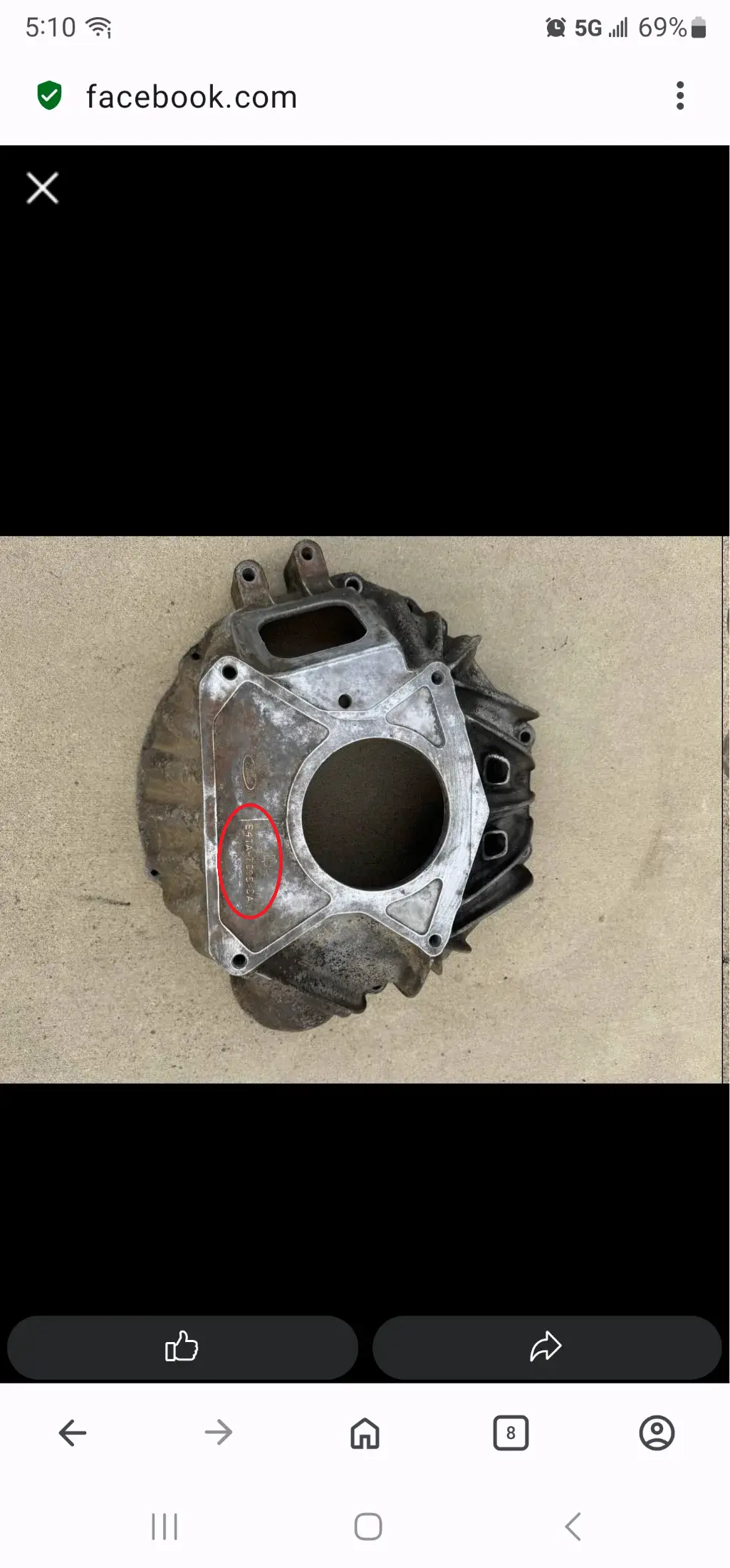

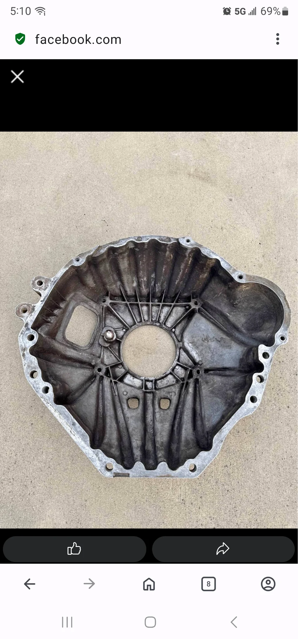

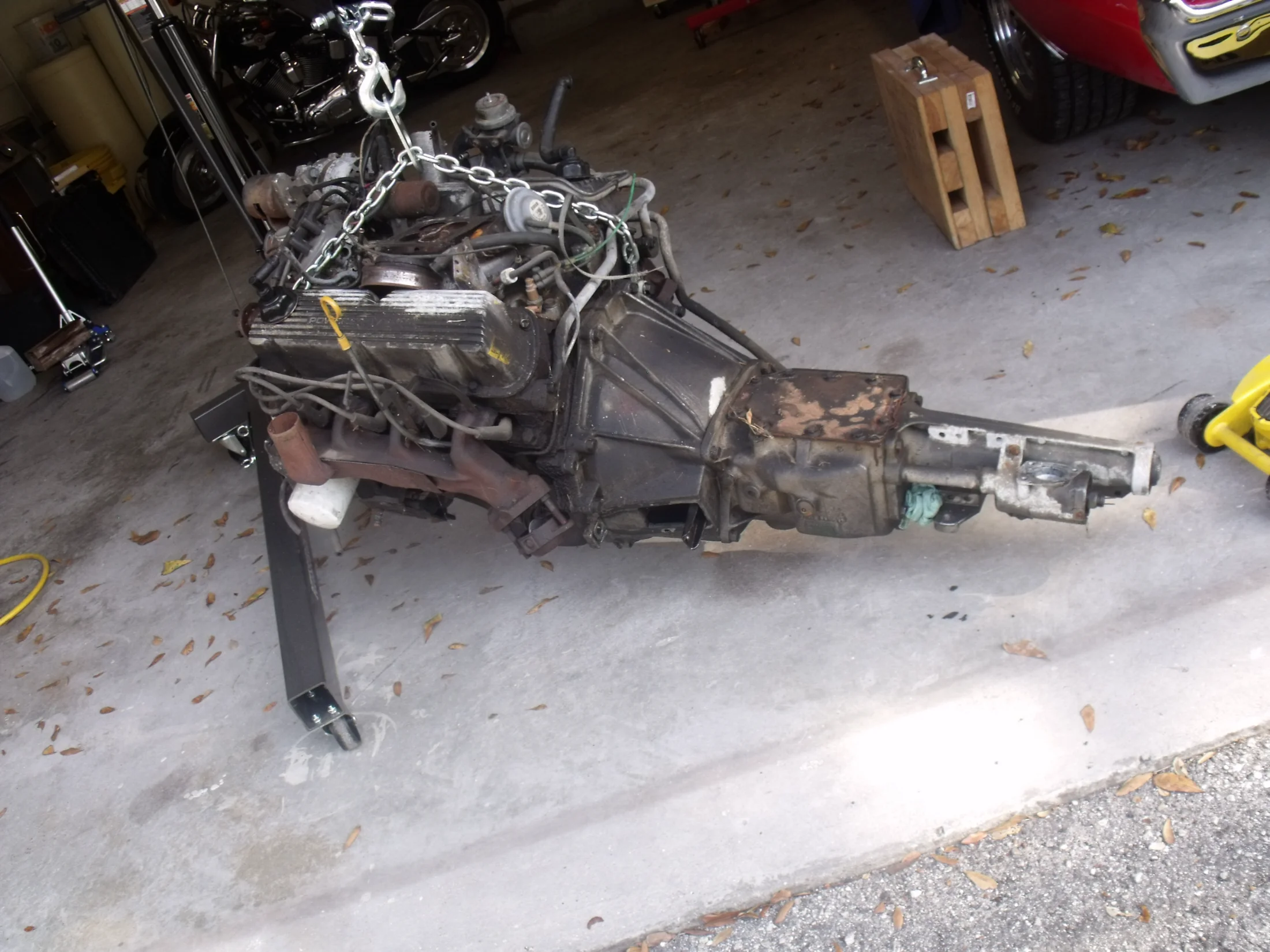

Can someone please help identify this bellhousing? I was told it's for a T5 and fits a 5.0 with a cable style clutch. Not Hydraulic.

It doesn't look like a foxbody V8 bellhousing. The clutch cable cover doesn't look right - angle looks off too.
The only V8 foxbody bellhousing I have seen start with E3 or E6. The trans bolt pattern looks more like a 4 speed or old 5spd

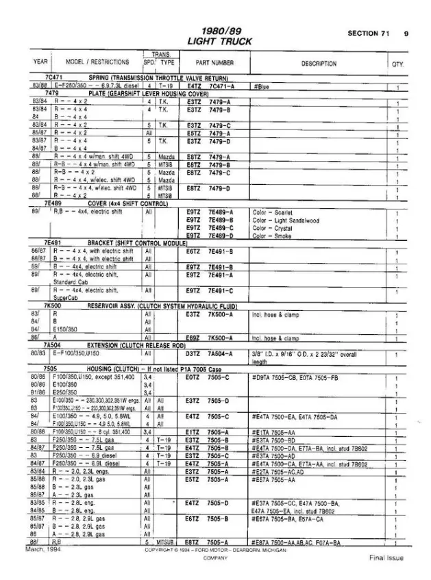

For use on a foxbody you will want one of these two...

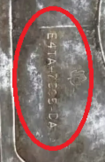

E4TA-7235-CA
This is a Ford part number. Here’s a breakdown:
E4 – Indicates the part was first released in the 1984 model year (E = 1980s, 4 = 1984).
T – Denotes the vehicle line; "T" often refers to Ford Truck.
A – Designates the engineering group.
7235 – Clutch Release fork.
CA – Revision code.
So, an 84/85 truck

That helps.. thank you! looks like my quest continues..

not to much of a difference, my T5 is a 87 going with a 86 5.0
What's interesting is the E3 bellhousings have the cast recesses for the SROD trans mounting bolts, they are just not drilled and tapped.
So an E3 bellhousing could be used for both SROD and T5 if you drill the other two holes.
Just food for thought.

That's an option if I can't find a E6ZR- 6394-AA bellhousing close to home. I just have to mate my 86 302 to my 87 T5, it's going in a 78 Cobra.
