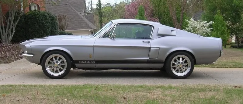

On my car with the GW drop and GW arms using GW small block springs my front end is too low and that is with 3/4" poly spacers. It actually looks great but the tires rub on large bumps. I am looking at going to GW big block springs to raise the front slightly and that, with the stiffer spring rate will hopefully keep my tires from rubbing.
My driveway slopes up, so the front end looks a little higher than it actually is. The top of the tire (245/45/17) is about 3/4" inside the wheelwell. Or I may go to a 235/45/17.
