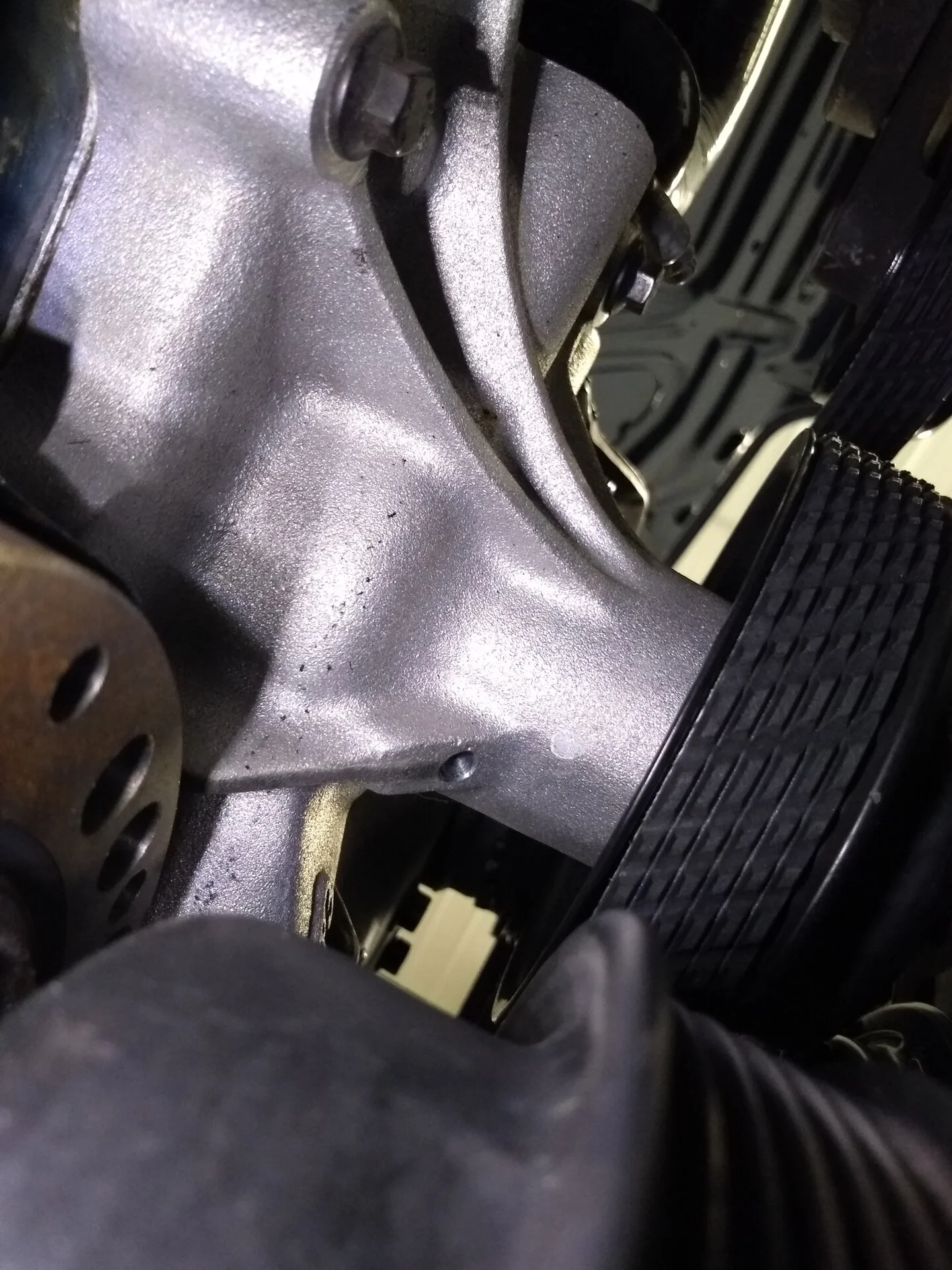

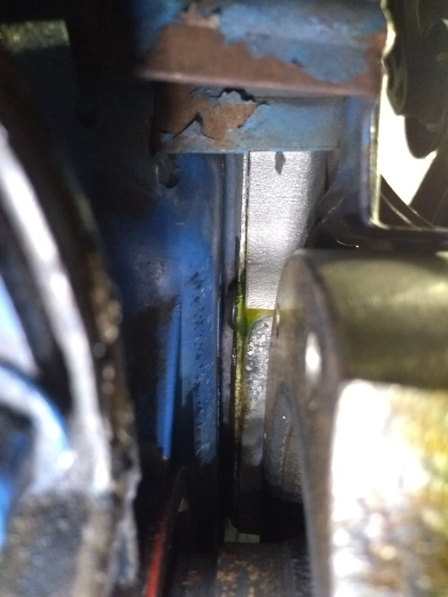

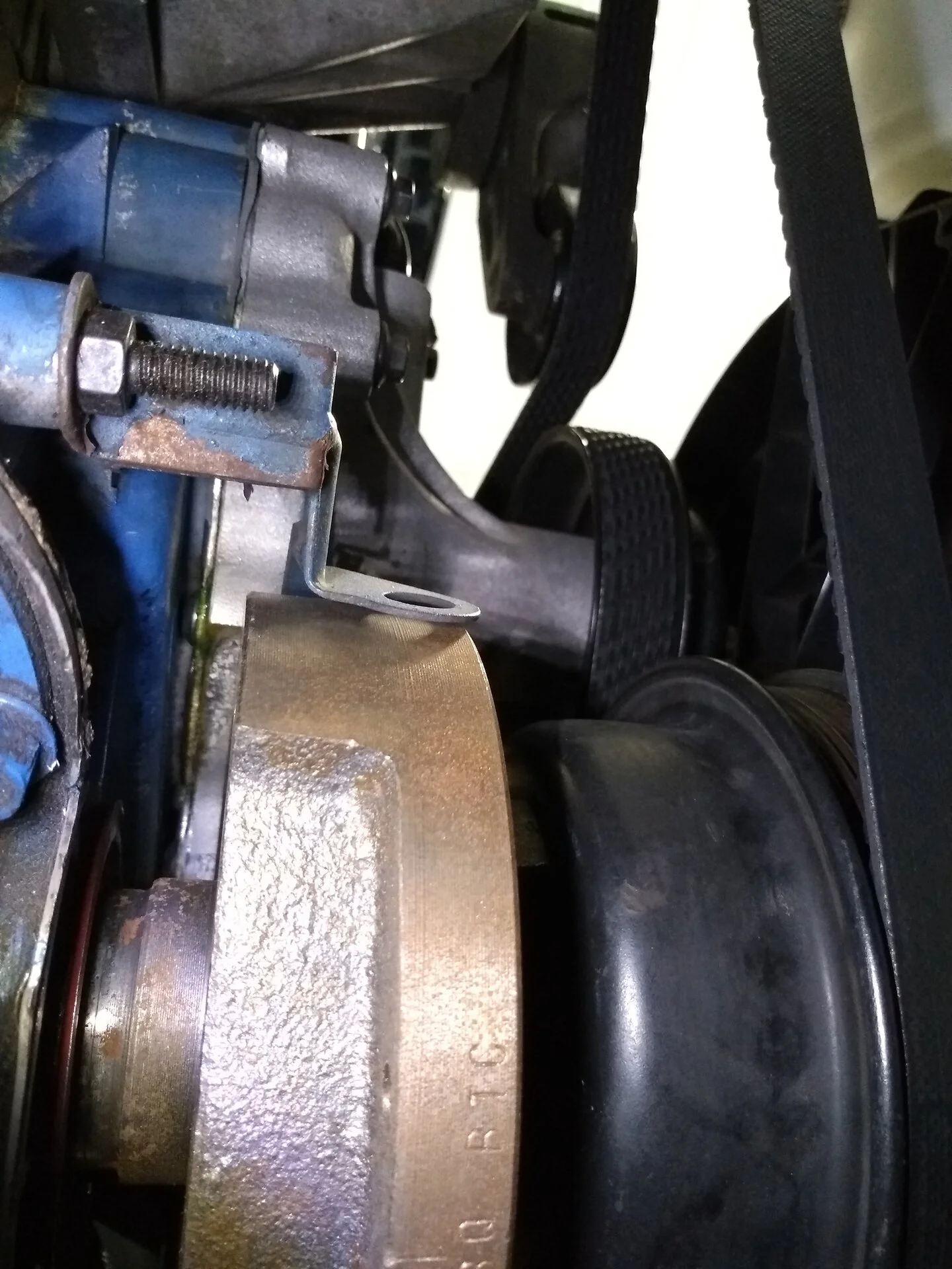

Hey guys,
Took the car out a bit ago. Drove really good. Until I looked underneath and noticed coolant on the ground.
I'm trying to figure out exactly where it's coming from. I'm leaning towards a water pump gasket. Everything on the top side of the engine seems dry. But want your opinion.
The water pump is a Edelbrock which was replaced by the previous owner in 2016-2017 I think. The weap hole area feels dry, but looks like some coolant has leaked at some point.
The picture showing the coolant leak is at the bottom area of the water pump.
I have a new timing cover and gaskets already. Not sure if I should replace the timing cover too? Or start with the WP as a lot more is involved replacing the timing cover.Any other WP brands to consider?
I've never replaced either before.

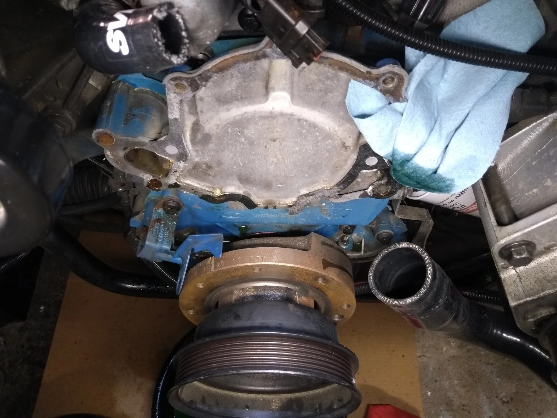

I started disassembly. Just not sure if I should chance trying the Edelbrock water pump or not.
I plan on using a high tack sealant on the gaskets.
Should I put anything other than anti seize on WP and timing cover bolts?

I always use thread sealant on the bolts.
Thanks for your help. I'll use thread sealant on all bolts.

Unless the pump is less than a year old, I would not reuse it without rebuilding it. If you do not have experience with a press, get a new one.

I'll bet you the gasket on back of wp went bad, or bolt on back( I belive 5/8" ) was loose.I ground down a open end wrench just for that.
Reactions: 91GTstroked and Monkeybutt2000
This. Stupid design anyway.

make sure you order fel pro pump and backing plate gaskets because the cheap black ones that come with the pump usually dont seal good
It appears the old gasket was a cheap black one.... I'll be going to local auto parts stores today in hopes of finding both water pump and backing plate gaskets.
