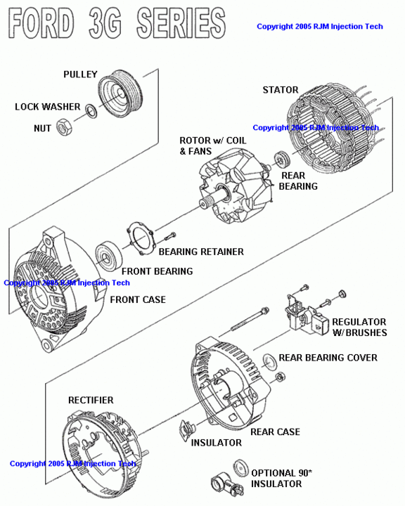

here is an exploded view of the G3 that might help you!
