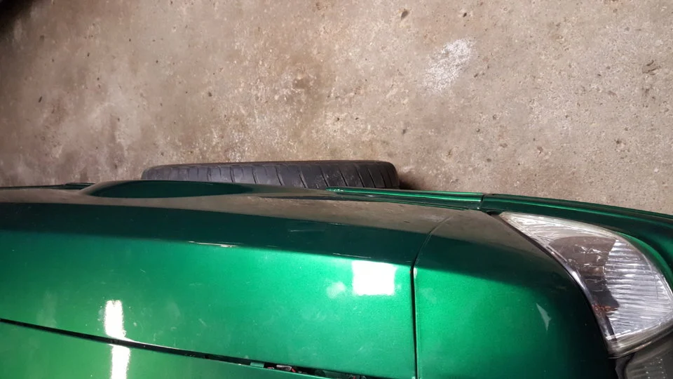

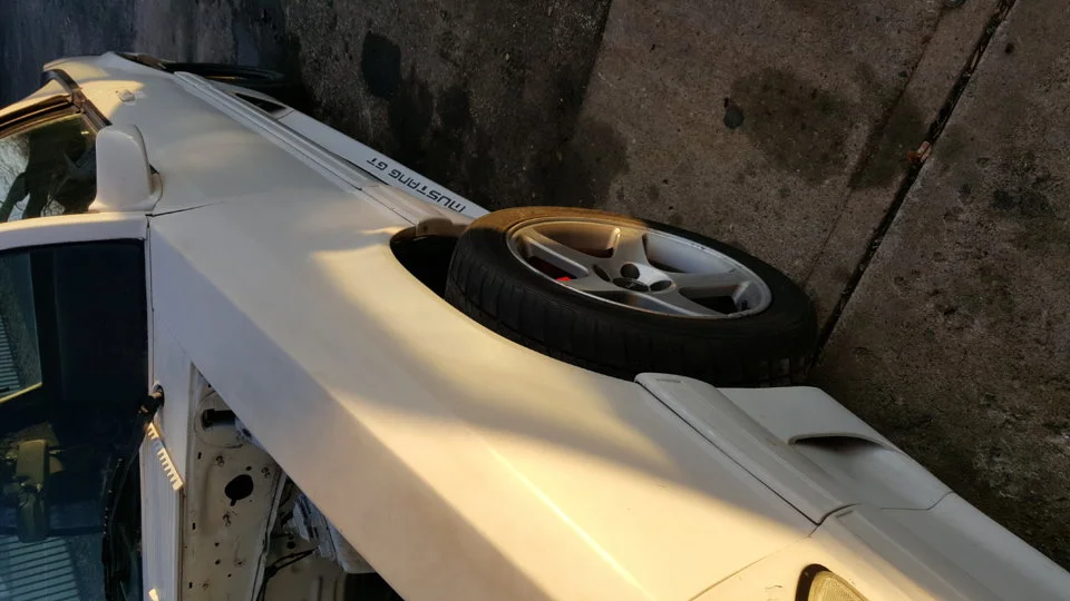

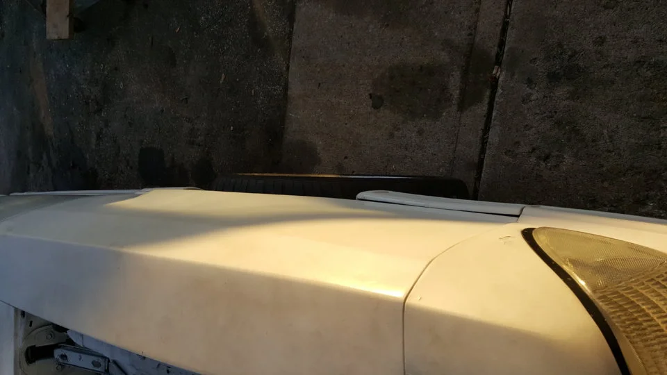

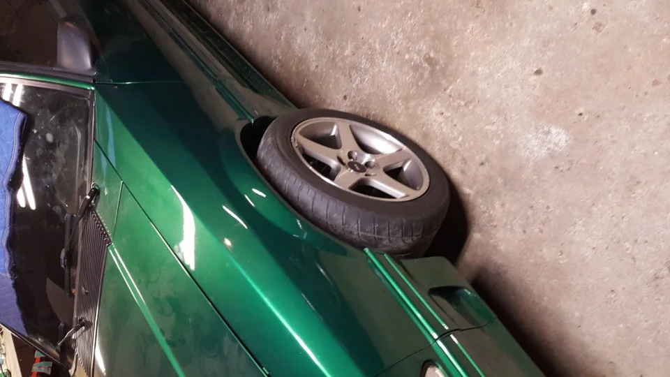

I went to a friend locally and he has the sn95 spindle setup. He let me test fit my wheel. And this is what it looks like. Does this look right. White car is his.

None of this makes any sense. Even with new edge spindles it shouldnt push the wheels out like that. Period.
By any chance has a spacer been welded to the rim?
Ok, assuming you did have the oddest plates in history,they don't push wheels out, and even if they did, that wouldn't duplicate itself on another car. The fact those rims don't fit on two cars raises an eyebrow.
Fwiw factory 5 lug bs is 4.5, 6.12 would tuck them in another inch.
I get what ur saying. But the cobra rims are 17x9 and stick out about a inch farther then my 17x8. But u r running 17x9 and have no problems. I just have no clue about this. It should be as simple as switching spindles and running setup just like urs and it would work
Which is why they have less back spacing to eat up that inch they would.normally stick out. Of your 17x9s Sat wrong on two cars then clearly something is up with those wheels.
