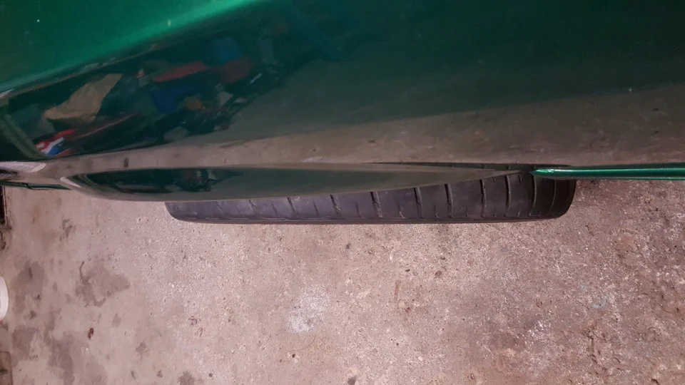

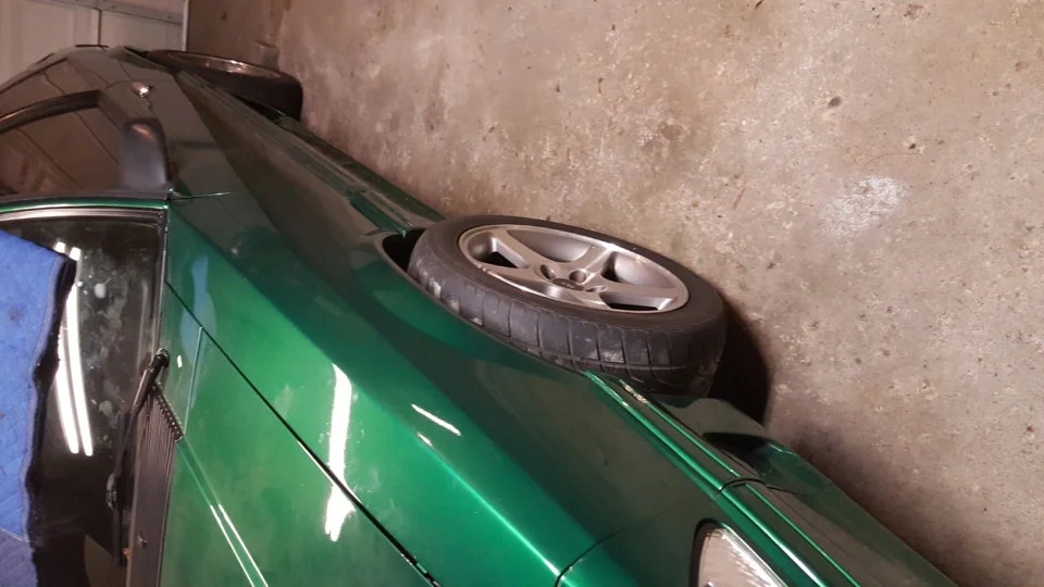

I have a 1987 mustang gt fox with the 5 lug swap.
I have oem 2003 cobra wheels that are +26 offset

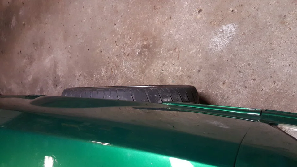

Rears fit great but fronts stick out way to far.
I know i need to get 245-45-17 tires for front but what can i do to make them not stick out as much

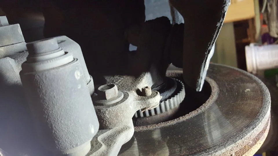

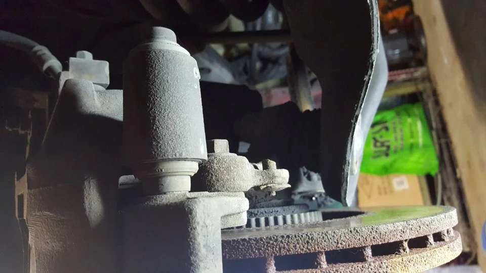

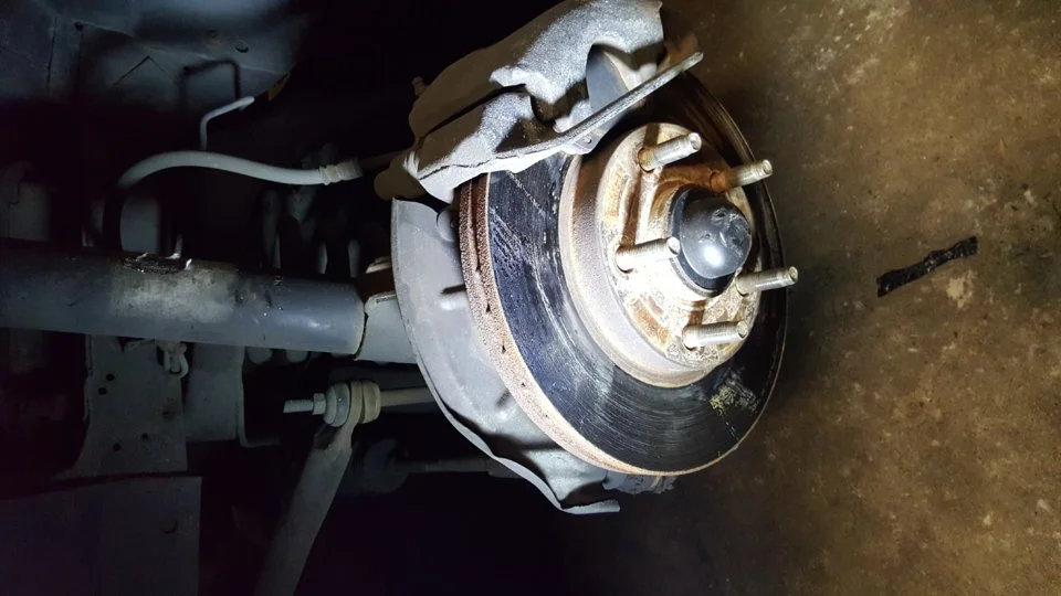

Until you know what you have, there is little anyone can do to help you. Is there a SN spindle behind that wheel? Is there a dog leg drop at the tie rod attachment point, or does it stick straight out?

Sorry my mobile phone auto correct is horrible. I will go take my tire off what do i need to take pics of and post because i do not know what im looking for.?
The 5 lug conversion could have been done one of three ways:
1. Using a Ranger rotor. This will be immediately noticeable as the rotor will be one piece, held on by a nut, washer, and bearing under the dust cap.

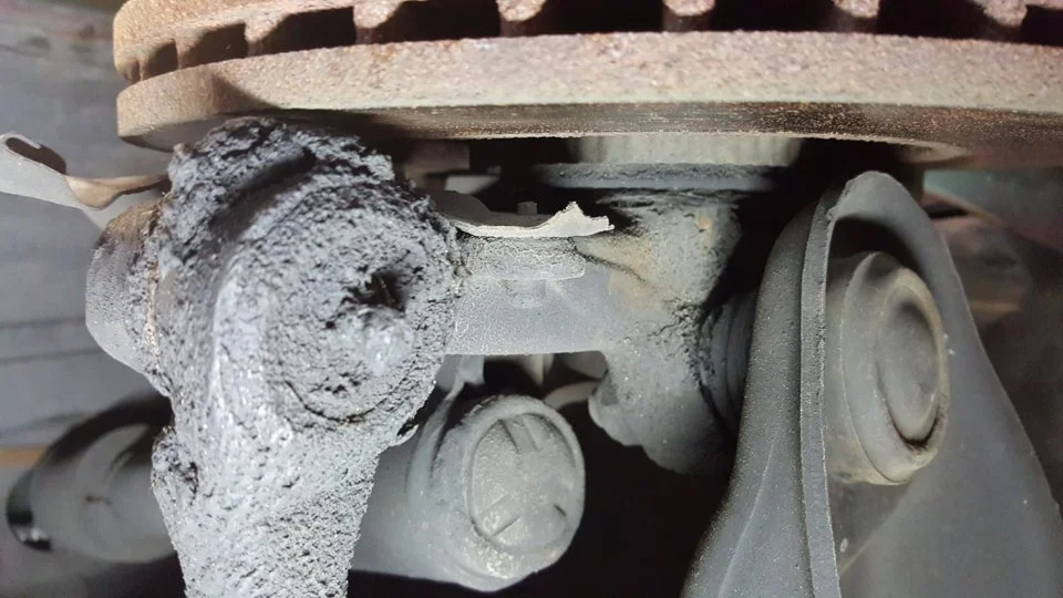

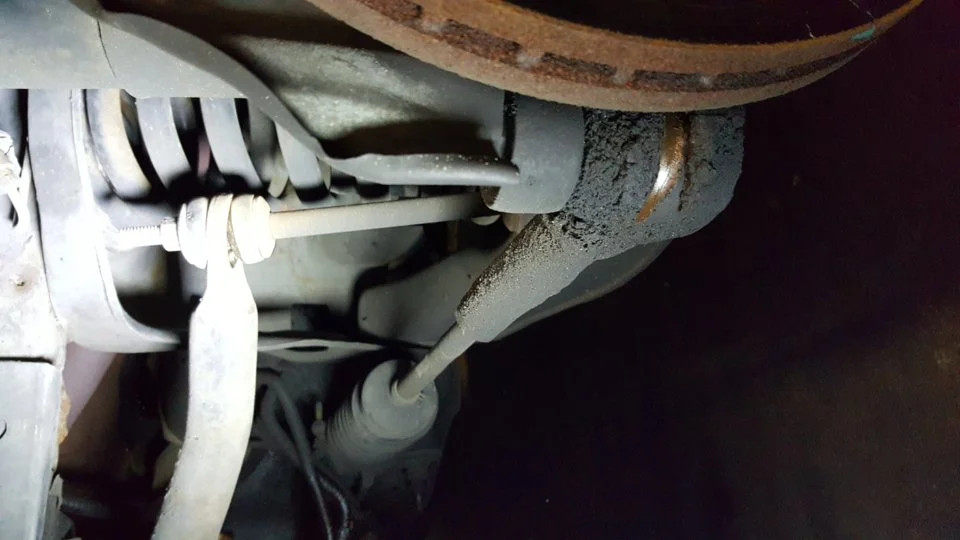

2. A " SN" spindle will be distinguishable because the rotor is seperately remove able from it. When you remove the wheel, the rotor is held on by little lock washers, ( probably missing) and the caliper. If the rotor moves when the wheel is removed, you have that.
3 the differences between where the tie rod attaches on a SN conversion dictates whether you have a 94/95 version, or something later than that. If you do have a remove able rotor, you are looking for a dropped dogleg where the tie rod attaches, if it sticks straight out, you'll have to change that spindle to get those wheels under the fender,...but that may open a bigger can of worms.
We'll open that can, after you take off the wheel.
Reactions: jrichker

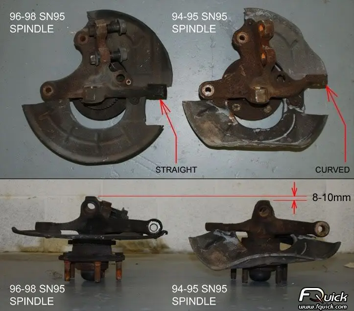

It's unclear what you have in your pictures you posted. You should be able to see for yourself when you look where the tie rod joins the spindle if the arm is straight or if it's curved like the illustration posted about in post #13. This is the best way to identify which spindles you have on your car. If the arm is straight then it's a 96+ spindle and that spindle will push your front wheels out which is why very few people will use those for a 5 lug swap. If you have 96+ spindles you'll either have to get a new set of wheels with a higher offset (for the front wheels) or you could purchase 94/95 spindles which will retain the stock fox track width and wheel offset.
I believe there 96-98. So all i have to do is get 94-95 spindles ? I measured and my wheels stick out about 1.125 inches-1.25 inches.
It will help but I don't think it'll solve up to a 1.25" protrusion. I think 96+ spindles only are responsible for about a 1/2" of that. Maybe somebody else can chime in on that. I believe @elarm1 has 94/95 spindles and Cobra 17x9 wheels. Maybe he can post a pic of his setup for us.
