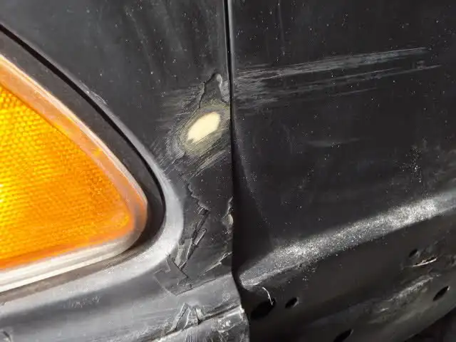

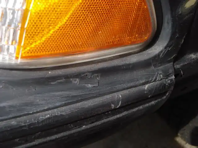

Hey guys I'm trying to do body work on my 87 5.0 with t-tops but I got a question. The guy who owned my car before me did not like the car. I have no idea what he painted the car with but i've got some real bad chips and pin holes and cracks and peeling going on on the front bumper. I've got a picture of the worst of it. Anyway I want to know whats the best way to go about this. Should I just sand the crap out of the bumper or should I put body filler or spot putty on it and make it flat? Also i'm not sure if I should use body filler on the bumpers. I've read that JB weld works good on working with bumpers and so does spot putty. Any suggestions on what to do/use?
FWIW, Bondo sells a flexible bumper repair kit that you might consider using. Only place I've seen it available at thus far is Checker/O'Reilly Auto Parts, but you might also find it or something similar at NAPA. :shrug:
I wouldn't recommend using any kind of regular body filler because it's going to dry hard and rigid, so it won't flex with the bumper. You'll most likely wind up with a cracked-up mess again if you do. :notnice:
Your best bet is going to be to strip down to the bare bumper( with sand paper or urethane same stripper. Next you need to clean it very well. If there is deep scratches or nicks in the cover you can buy flexible filler. Then use a adhesive promoter and flexible primer.:D
I'm in the process of getting my car ready for paint and i completely stripped my front and rear bumpers.I used a small detail sander, i started out sanding by hand and after 10 mins of that i said F that.:D Like IApony said get yourself some adhesive promoter and flexible primer and you should be good to go.
