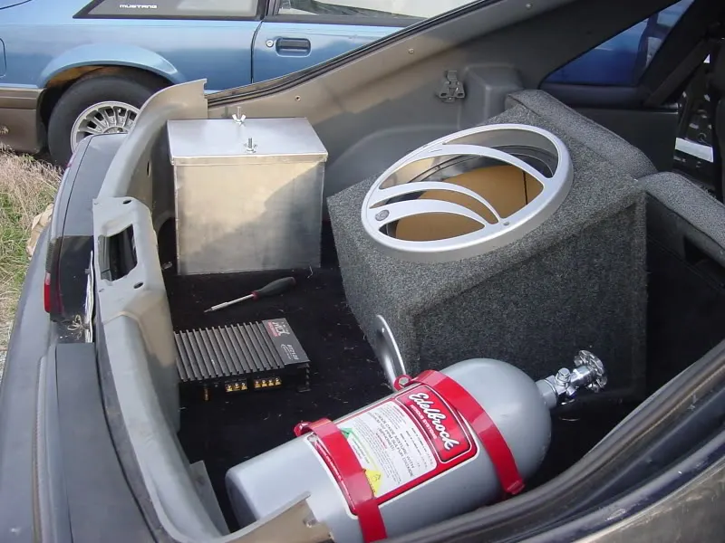

well thanks for all the replies so far keep em coming. Now i already emailed thumper as of last nite about porting and valve springs, but what do u guys think i should do to the heads machine shop wise? this is a street car that will see the track but its important to me to have low end power because it is a street car and its an automatic.And besides i have nitrous for top end powa.:D But what are some important things that i should definately have done to the heads. I dont have much money but i dont want to cut corners so nothing crazy. thanks
