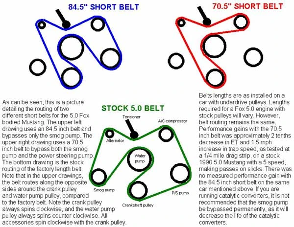

According to this picture...
This is My engine I just drew becuase I cannot upload a pic of it for sum reason.
My Power Steering pump is where my AC compressor should be and I dont have a smog pump.
This explains why my AC blows hot air lol.
So what has been done to my engine? And do I have underdrive pullies? If not what are they?

The picture you drew is the same setup as my engine. I no longer have a smog pump and my engine is not equipped with AC.
cars not equipped with air conditioning had a bracket that raised the power steering pump up to where the AC compressor normally sit. This same bracket is offered by ford racing as an AC delete kit.
I can't tell if you have underdrive pulleys or not. You can only check that by comparing the diameters of your pulleys to those on a stock setup.
