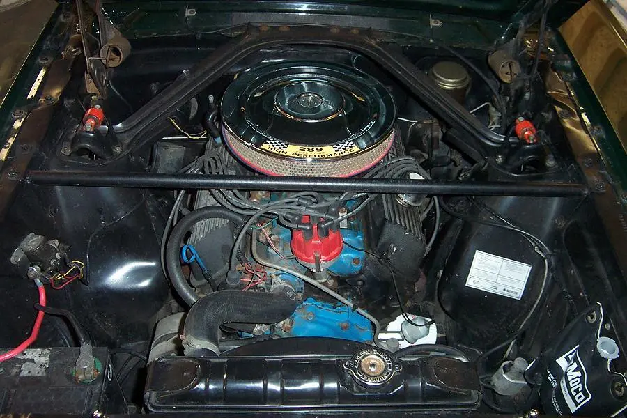

A 289 long block will fit in any Mustang from '64 1/2 to '96. Depending on the year and what state you live in (emissions regulations & testing) will determine what equipment you need.
My '66 has just an alternator (no P/S or A/C) and just one vacuum line - to the PCV Valve. Pretty basic. Fuel line runs from the pump to the carb. There are literally hundreds of accessories available and should be matched to the car and how you will be using it. For pix, just Bing "289 Ford" and select "Images".

Who would guess that this is an '85 5.0HO?
