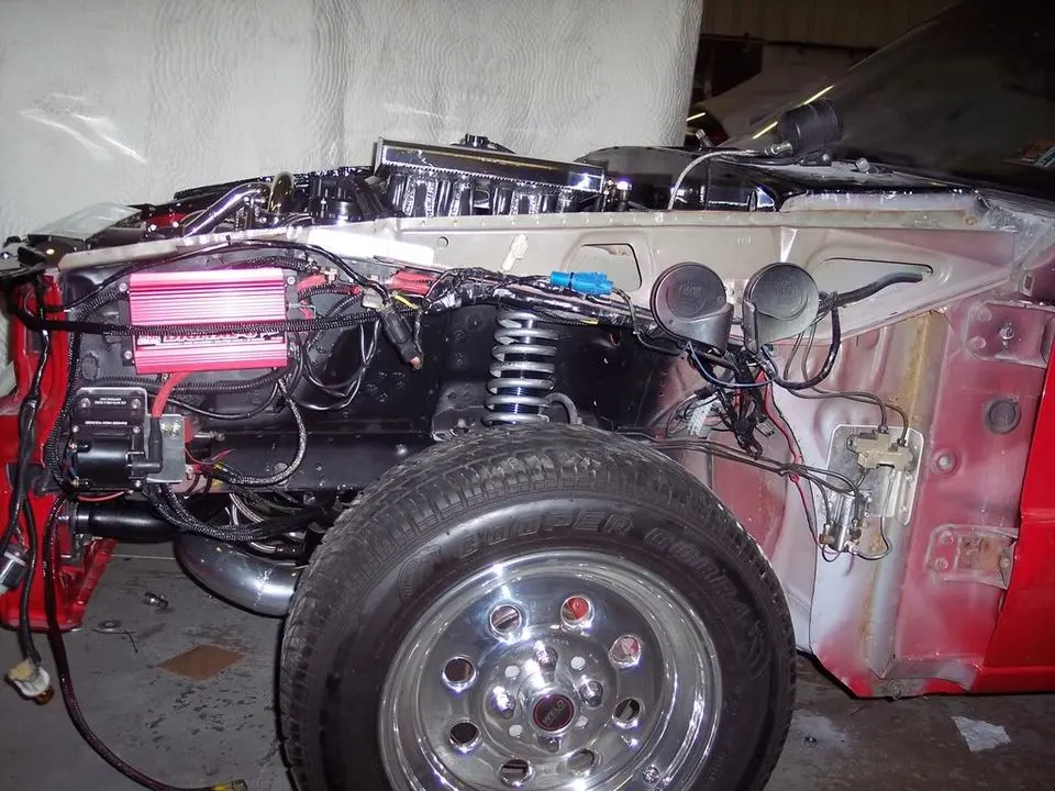

Ive been looking at other guys different ideas and everyone seems to have diiferent opinions on how to run the wires, I know its time consuming and all these guys did a great job on their cars.I been working on my stang for a while now and this might help you out i used some of my stock grommet for this.That way it looks more proffessional(even though I did it). her are some pictures that might help.let me know if you want more pictures.I put other pictures of my suicide hood hinges and shaved compartment im working on.

Well most of your wires meet in the middle of your engine compartment so I got every wire that I dont need to go to the engine and ran those wires under the fenders, The only wires that are coming out of that grommet you see is the injector wires,the distributor,the vaccum lines oil pressure wire and the water sensor but they are all atatched as one any ways you dont really split that up. the rest of the wires on the right side will be headlights, and if you have airbags. the left side will be the coil,the horn, cruise control(if you have one,took mine out less weight and hardly use it anyways I think i waste more gas that way.Used my buttons for line lock.)I know Im forgetting something but not sure i'll check tomorrow for you.Oh i also put a grommet coming out of the left side of driverside I'll post some pictures later for you.

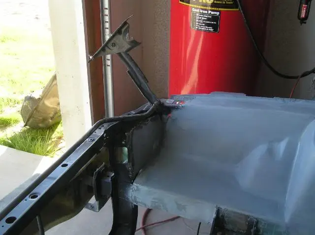

Heres another picture for my wires.its a little dusty so don't mind the dust.LOL
