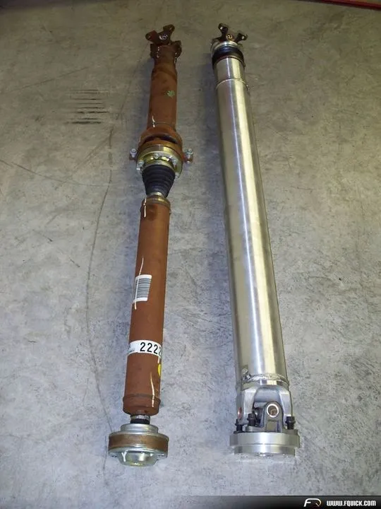

Think about it you have a revolving two piece boat anchor of a driveshaft that zips about like Indiana Jones' bullwhip when under stress. It is also connected to your live rear axle and jerks it whatever which way when torque is applied and released.

I bought my Coast 1pc Alum DS from Tillman Speed.
I believe there's actually 1 U joint and two CV joints on the OEM boat anchor.

2 piece
A 2 piece drive shaft reduces drive line vibration and feedback, which makes the car quieter and smoother.
As you can see many people complain about noise and rattles....If Ford had installed a 1 piece drive shafts the complaints would have gone up even more.
