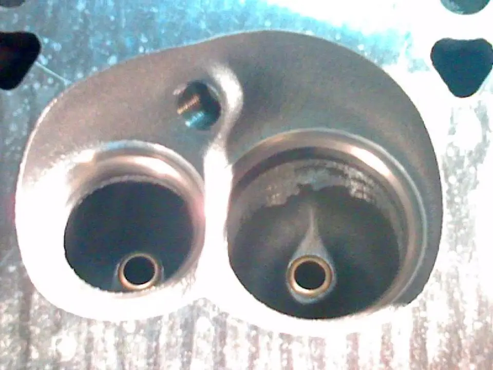

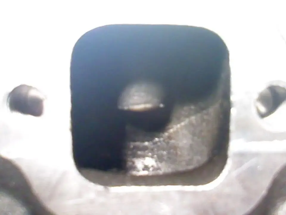

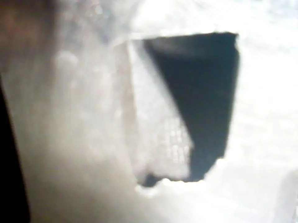

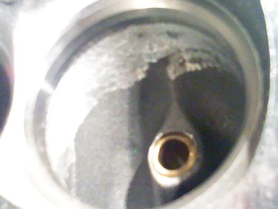

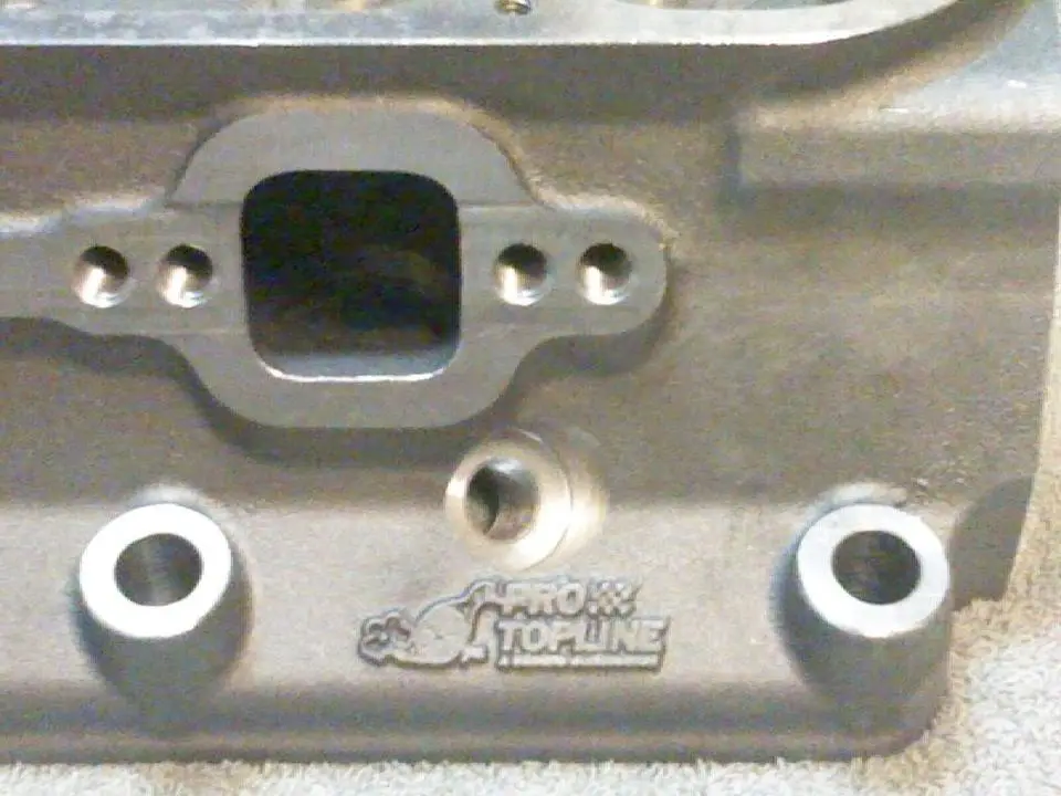

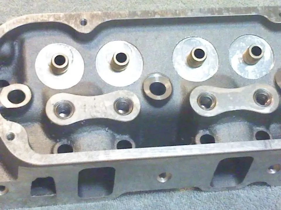

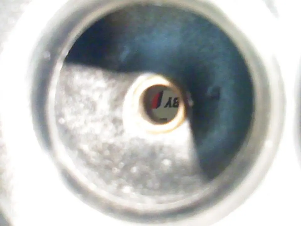

Will upload some pictures shortly of the heads I just received today. They have quite a bit of casting flash and will require some cleanup. It looks like someone already took a dremel to the insides of the ports to reduce some casting flash. Overall they seem to be ok except for neeeding the casting flash smoothed out. But for the money I'm saving I don't mind doing that. Pictures within in a few mins if all goes well....
Heres a few pictures of the heads.
As you can see someone has taken down the excessive casting flash inside the bowl area. They didn't hit the valve seat or anything. It all needs to be smoothed out for sure.
This is a good example of just how much casting flash is on some locations.
