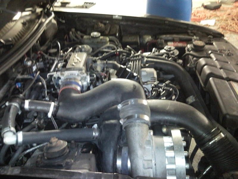

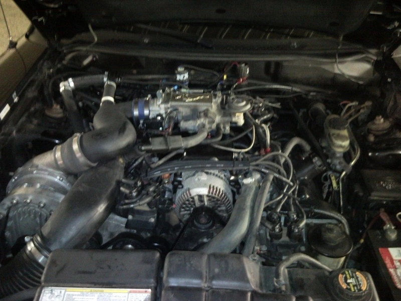

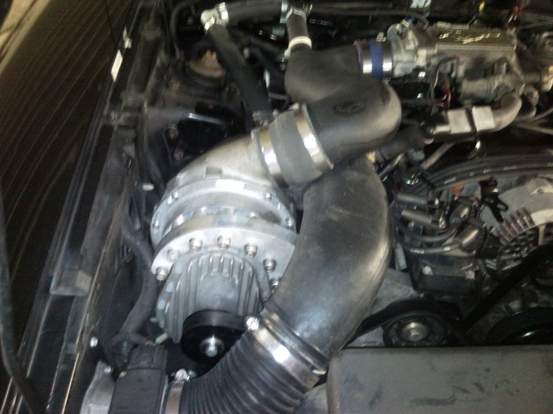

Here are some pics.. I will get better pic later, I just found those on my phone i took Sat at my garage.
Sorry. the old motor is gone..and the last owner does not seem to want to talk to me.
This motor is all stock. The guy that put it in said its not the normal motor.. He give me two name. The one that was the 1996 and the 1998 i have now. This one i have now, i don't think i have seen pictures of it online. The oil cap is on the driver side. Too bad i don't remember the name. Winsor something like and something else...
The color injector don't match my stuff. I have some old pics of the last motor, the injectors either look black or something dark. Again.. the guy who used to own the car won't talk to me.. what an ass.. its like they got something to hide... maybe she kill him.. LOL. This car was traded in at a dealer about a year ago. It could have easly sold for at least 6k or even 8k.
I don't think i have an FMU. I am sure i would have seen it.
Yeah, i can't really see anything in the pics. I would take it in to get tuned for those 42# injectors you have, they should more than handle what is on the engine unless you have a really serious cam and heavily ported heads, or your blower (looks like a powerdyne) is making over 15# of boost. When you get it to the tune shop make sure that they change the plugs, don't bother changing them until you get there.
doesnt look like a stock mass airflow sensor housing. as stated above, you need a dyno tune to get this right.
Also, stop driving it or you will destroy that motor. Even driving it easy could destroy the motor. Too much fuel will wash your cylinder walls and not enough will cause detonation. both will lead to a destroyed motor and can happen no matter how you drive it.
