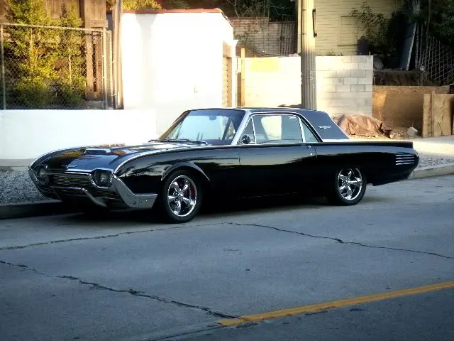

LOL! I also have a classic Bird! I call her "Blackbird"
and she is also for sale! LOL!
John
