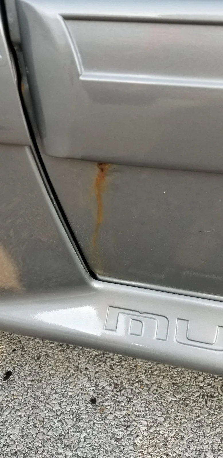

1....can I stop this from spreading(pic) attached

The pic looks like a rust bubble near the trim.
Open the door and check for rust near the bottom. Remove the door panel and look at the spot from
The rear, that’ll give you an idea. But remove all rust, prep and paint. Treat inside of door.
