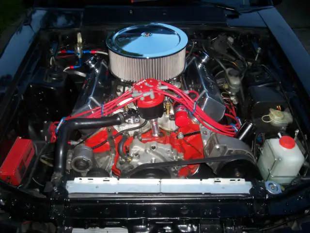

That will be a blast! Hey do you have any engine pics by chance? I was gonna build a 460 but i'm going with a 408 instead. I was just courious how tight of a fit the 460 would of been? peace
john:p
here ya go:
