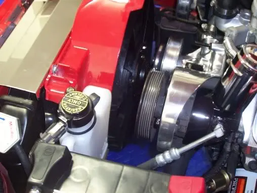

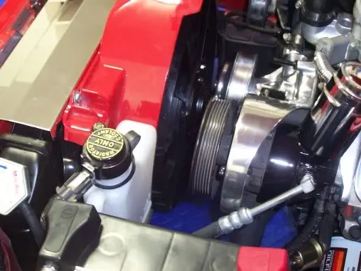

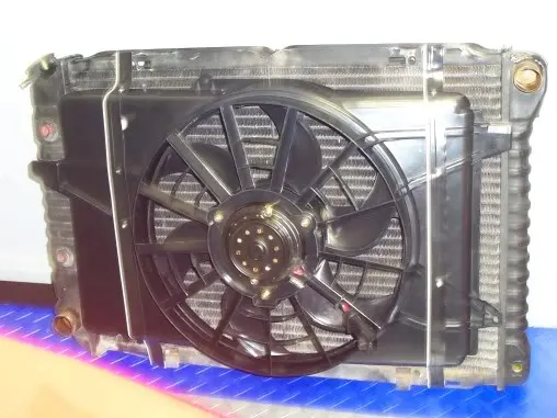

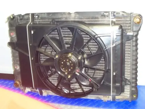

Aluminum strap, screws into the shroud and ends of aluminum strips folded over the rad edges...perfect for my setup. The pics are mockups on my old rad for fitment check.

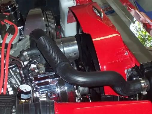

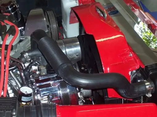

Then with some playtime and a saw I worked the stock shroud back to position.
Tape the ends of the straps where ever they come in contact with the rad to prevent any possible damage from metal on metal contact. The fan is SECURE there is no movement or vibration. Another nice feature is the stock shroud hides the fan making for a clean install in my opinion.....final pic is just shows fan clearance on the water pump pulley.

Thanks man...if you take a little time and fight with it you can keep the top portion of the fan shroud, you just need to get inventive with a saw to get the fit. Make sure you have the fan in it's final position before you begin to mod the shroud.
