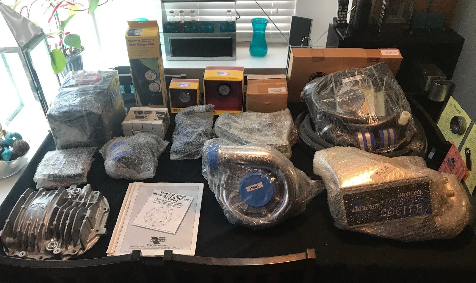

  • It came with a new vortech V2 kit that has yet to be installed. The only part the previous owner got around to installing was the fuel pump. (hence my original question)

  • Anyone have any idea what type of fuel pump would have come with a vortech v2 system bought about 2 years ago? Doesn't really matter, cuz I'm going back to stock anyway, but it would be nice to have some confidence that this is indeed the problem.

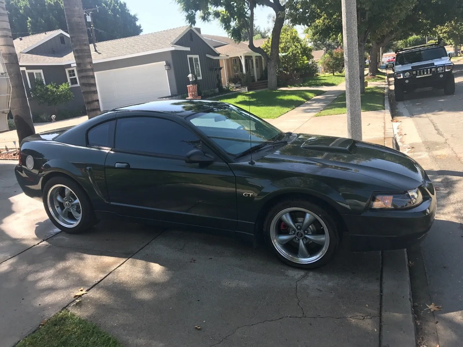

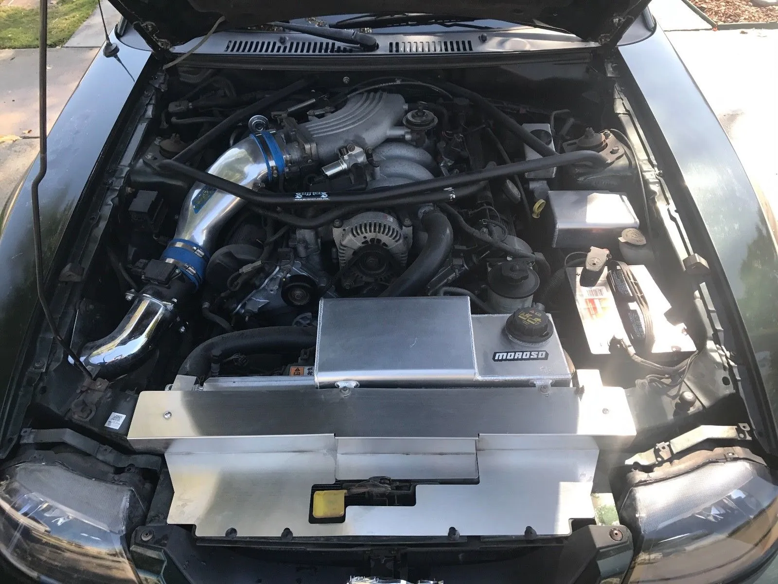

for what it's worth, here she is:
