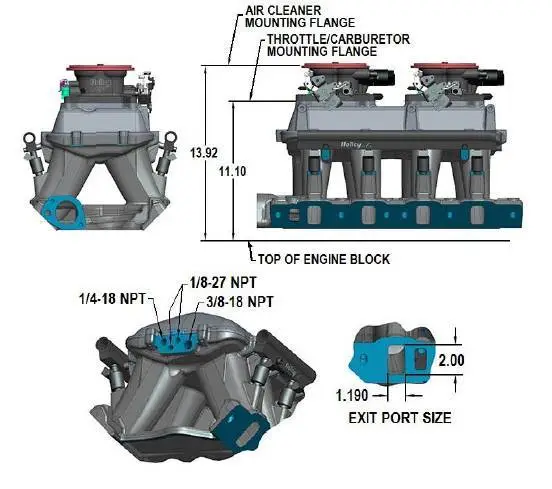

Here’s one flipped for your reference.
Keep in mind you will be able to purchase just the lower and there are plenty of guys that make nice lids. (417 motorsports below)

Hmmmmm, that may be a little too into the cowl, was afraid of that.
Probably the same info you already posted up-but it’s in pic form
I stole it from this guys thread-

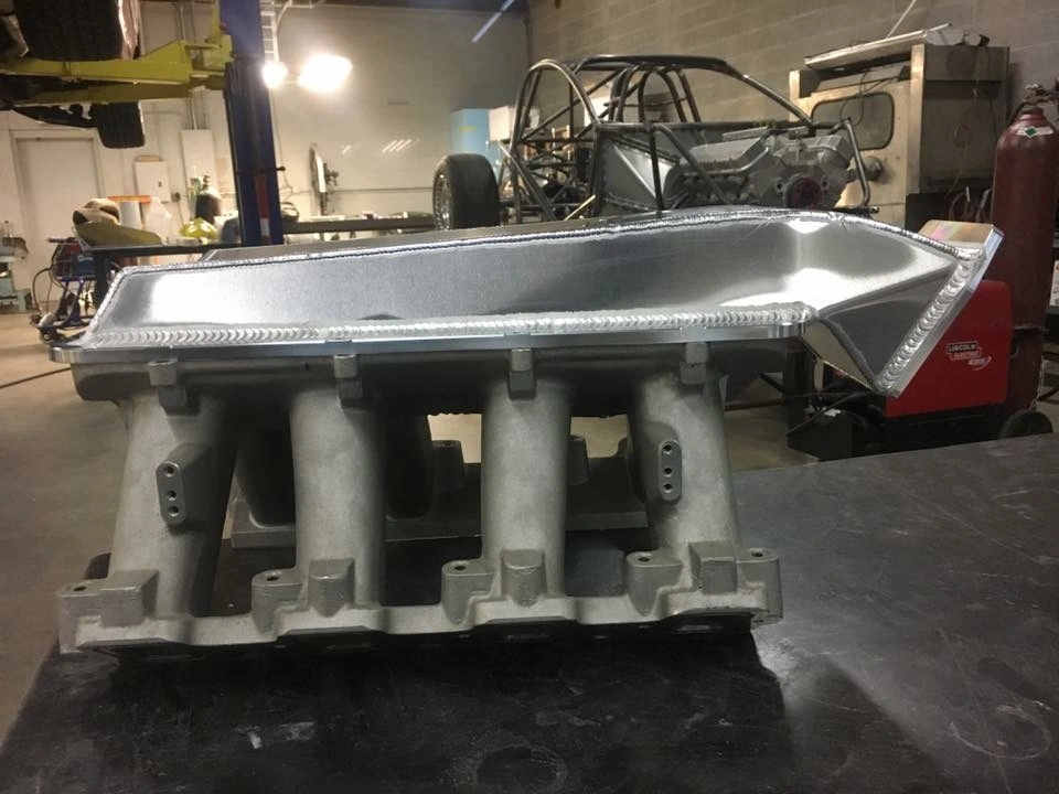

Flow and distribution. For something high rpm/big cube in the w platform that was efi ready from the box (without going full custom sheet metal) you were basically limited to a tfs box r (good distribution, decent flow, but too small for some of the wilder n/a builds) or a super vic (short runners, small plenum, poor distribution, and still small, a 4150Tb has just a touch less csa than a 90MM single blade). Other carb intakes can be converted (chi 4.0, glidden, etc) but you still have distribution, plenum, and clearance problems and all need to be ported.

did some more measuring today, looks like the max i'll have over the distributor hole is 10-11" unless of course the 2.5-3" cowls hoods are actually that much taller in the front than a stocker (im guessing my current 1.5" is only about 1/2-3/4" higher that far forward?).
whats weird is i could probably fit a milled box-r, which is overall taller than this holley, just further back. i think it would work turned around though, would just put the t/b in the actual cowl/firewall, which for nhra/class rules i dont want to eff with. also don't want to go with the massive cowl so its not as obvious what kinda power the thing will be packing (want it to look like a normal 12-13 second bolt-on fox instead of the hopefully high9/low10 it should be).

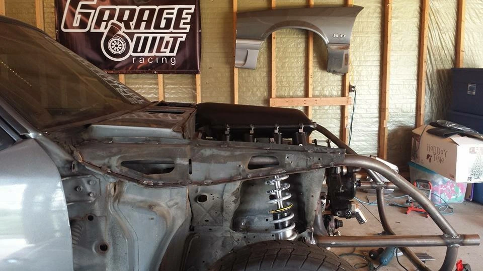

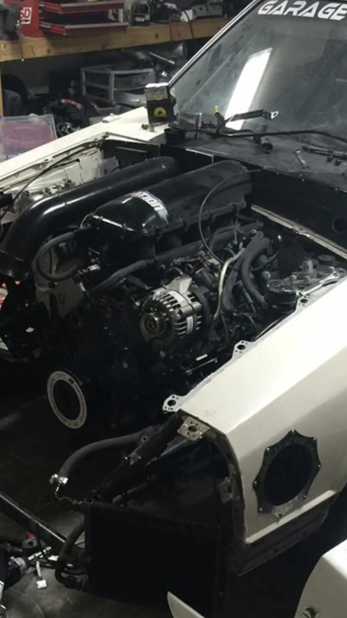

There are a lot of folks who think a big cowl Mustang is just for show. I showed up with my car at the drags and was going through Tech inspection and a guy came up to me and told me he had a pair of SFI pants that might fit me if I was interested....once I got my car "fast enough". I laughed and told him it was OK, I was already set. He had no idea how fast my car really is, to him it was a Mustang with a big assed hood pretending to be something it was not. Needless to say, it is much quicker than what he was driving...lol
[/IMG]
You also have a big-assed supercharger to cover up and are racing in some of the bigger events. Mine will just be an n/a street car that can go racing and not embarrass myself at stuff like true street and drag week, and maybe get a little grudge racing action.
