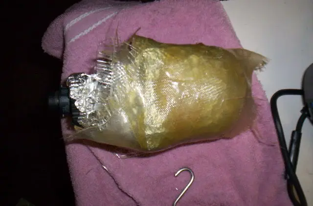

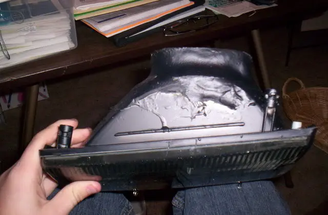

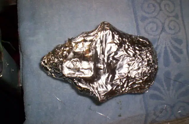

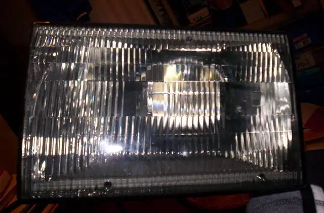

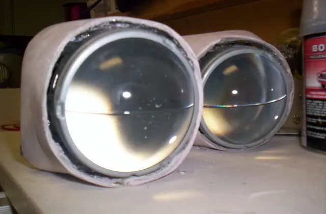

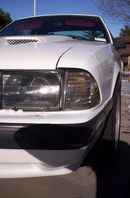

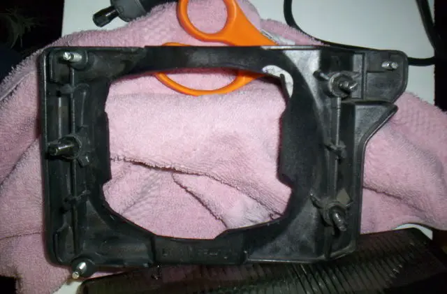

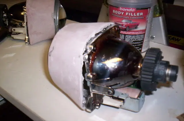

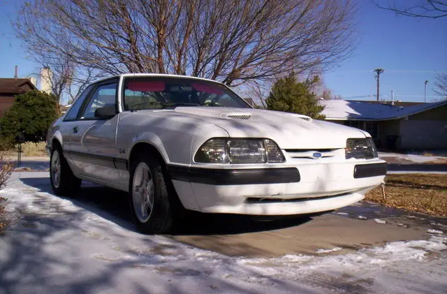

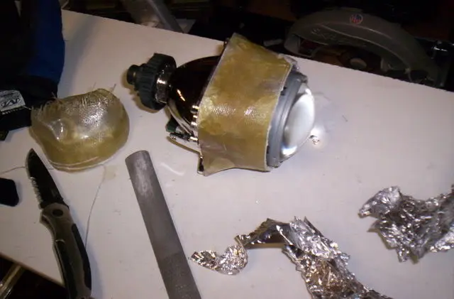

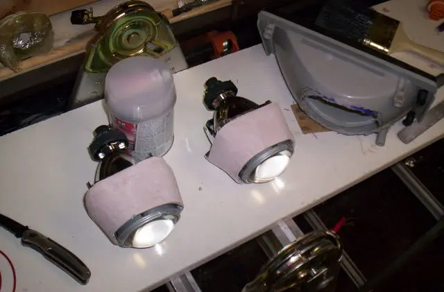

281pony said:
anyone specifically done this on here? i'd like to do this to my fox, ill pay someone for their mad skillz.
note... those are smoked stock style lights... they would have a perfect cutoff line without the fluting... such as the ultra clear lights.

That's exactly what I want. You wanna do another set? Pm me what your time is worth.
