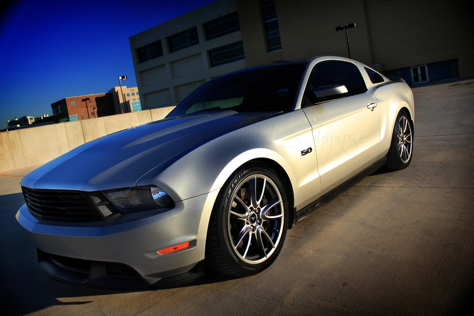

I have a 2011 5.0 with pretty much every option available, except the HIDs and the glass roof, which I wish I had gotten. Either way, I have the standard headlights, because I thought the HID ones looked strange. They're just now growing on me, but thats too late. So I installed some 6000k dual beam HIDs in my headlights, and i think they came out pretty clean. I did this a while back, about 2 months ago, but I never put up any pics. Me, not put up pics, lol, imagine that.
Anyways, I think the factory head lamp is better on this style mustang SN10, than my last S197, as you can see the cut off is much sharper.
The car.
The wall in front of the car a few hours later.
I know it's not all "razor sharp cutoff" or anything like the actual HIDs, but it's pretty damn close I think.
