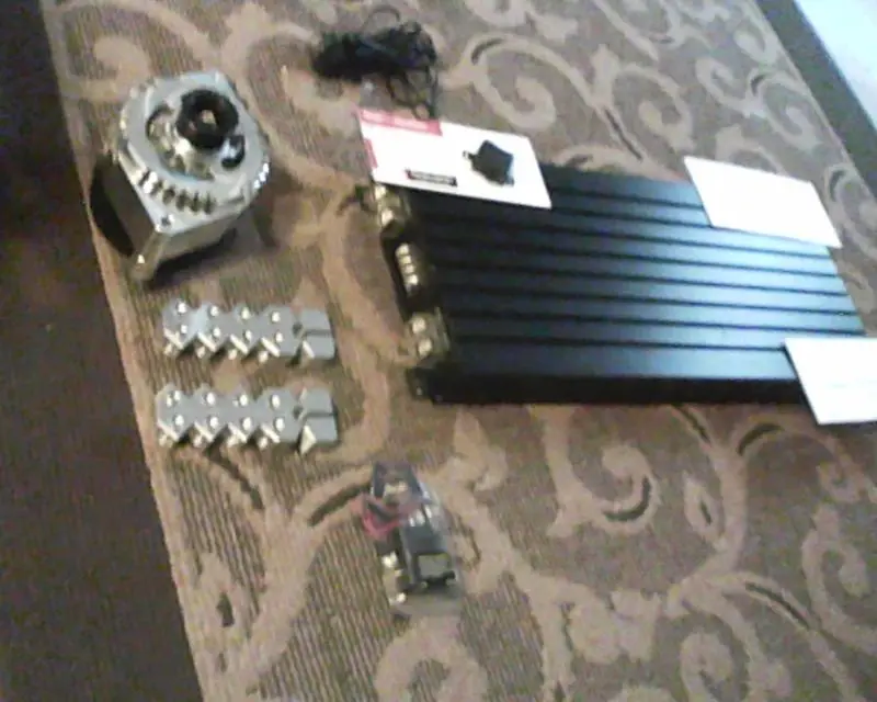

eh im just looking to do a slot port prolly i know a guy that used to compete in db drag, even world finals, he is now the local db drag certified judge and make speaker boxes with a cnc machine with bracing ect, all the good stuff, ill have to see what he thinks but yea id like to go as big as possible but i need room for 2 batteries back there and a 25 inch long amplifier and another 18 inch long amplifier
as far as subwoofers i already got the apx 18 picked out i can get a great price on them and they are ridiculous and can be customized to order, powder painted, 3 or 4 inch coil, custom impedance, whatever ya need

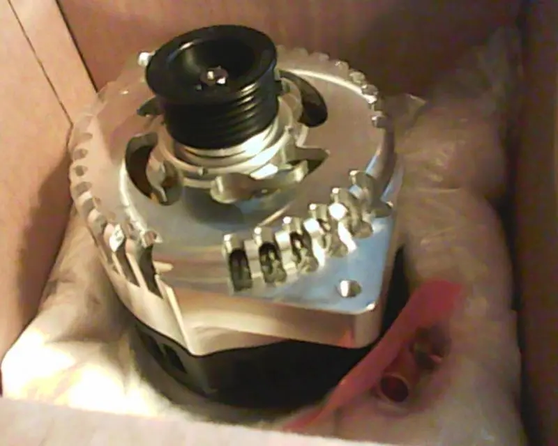

already got quotes from singer ,mechman,excessive amperage,dc power, and ohio generator all good prices the dc power is a little high, with ohio generator being a great price for the 300 amper (competitor pricing) its a toss up between excessive amperage and ohio generator i think
I want to find out what engine rpm equals alternator pulley rpm, to help figure out the output at idle on the ohio generator im seeing values around 225 amps at 3k alternator rpm and 290 amps at 4k alternator rpms and over 300 amps at 5k alternator rpms
Reactions: 85rkyboby

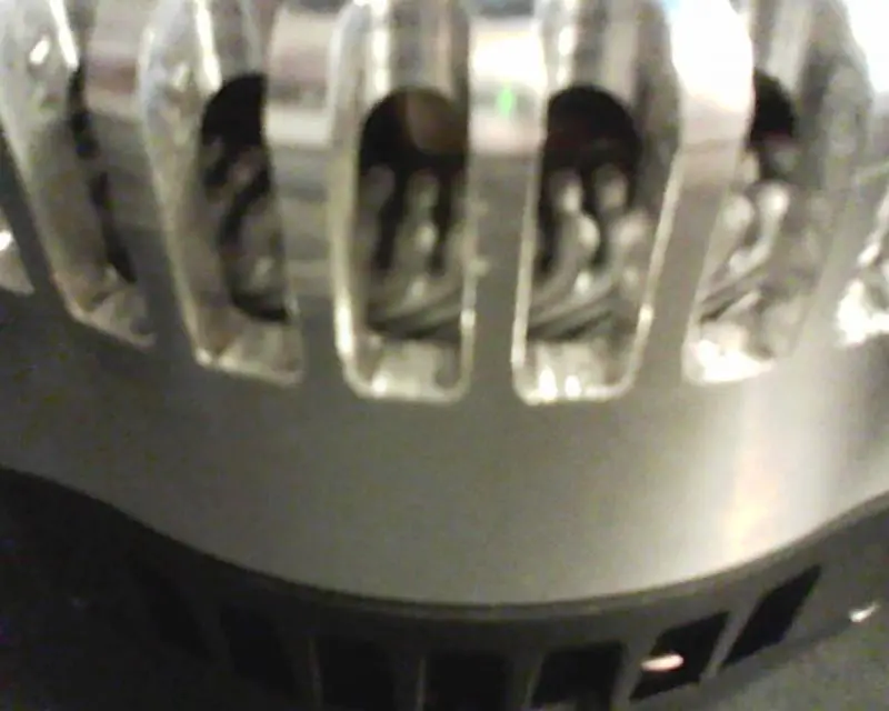

singer dont do a hair pin for 3g yet hes 8-10 months away from it
Mechman makes a hairpin 320amp thinkin bout goin with that price is decent too only like 60 bucks more then 300 amp conventional
