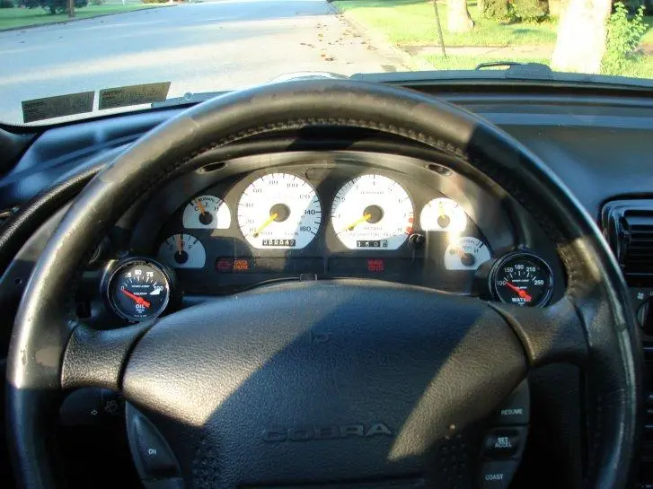

svttech76 said:
is it easy to see it there.. I had them on the pillar in another car and that worked well
here it is eye level
