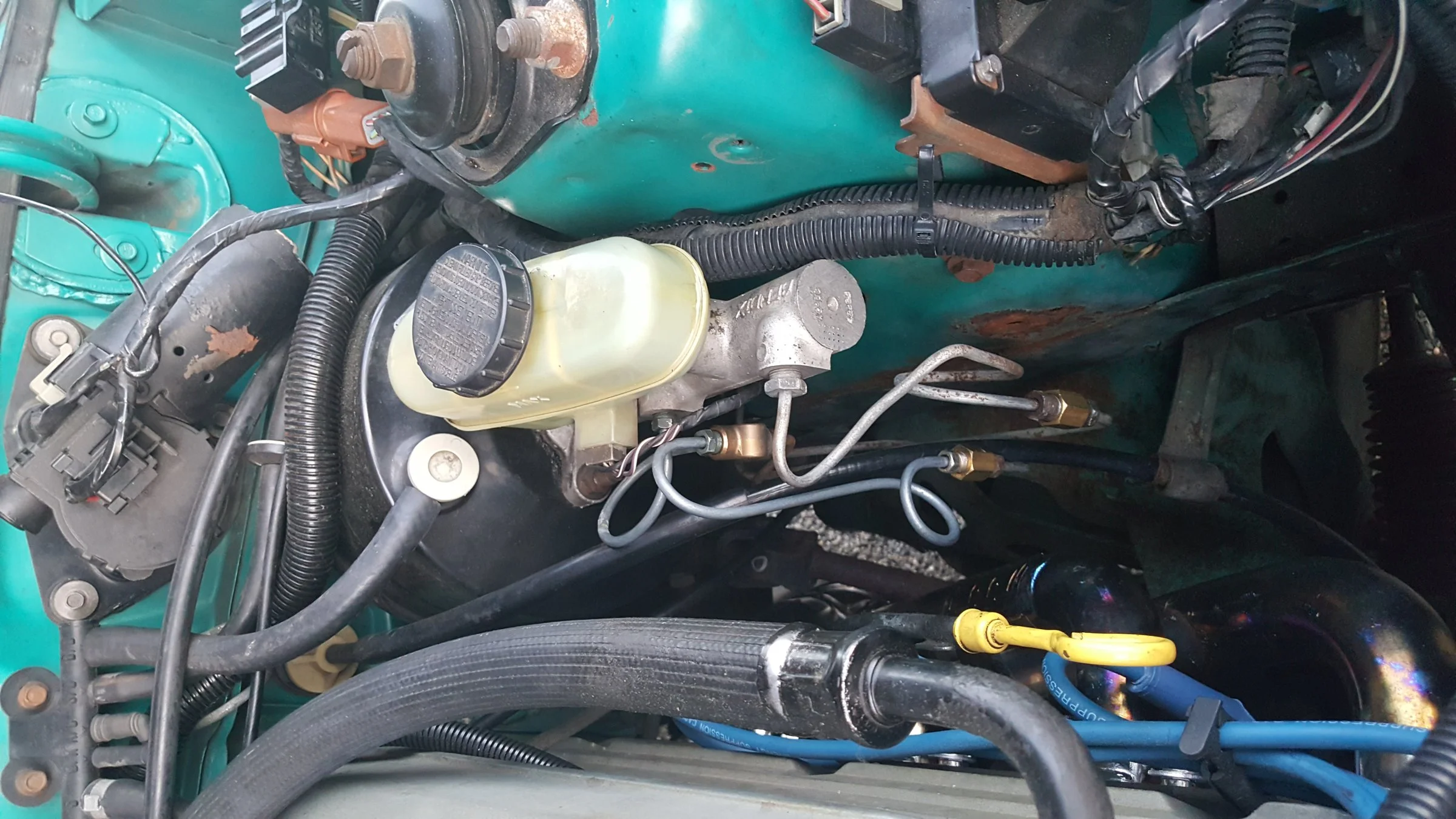

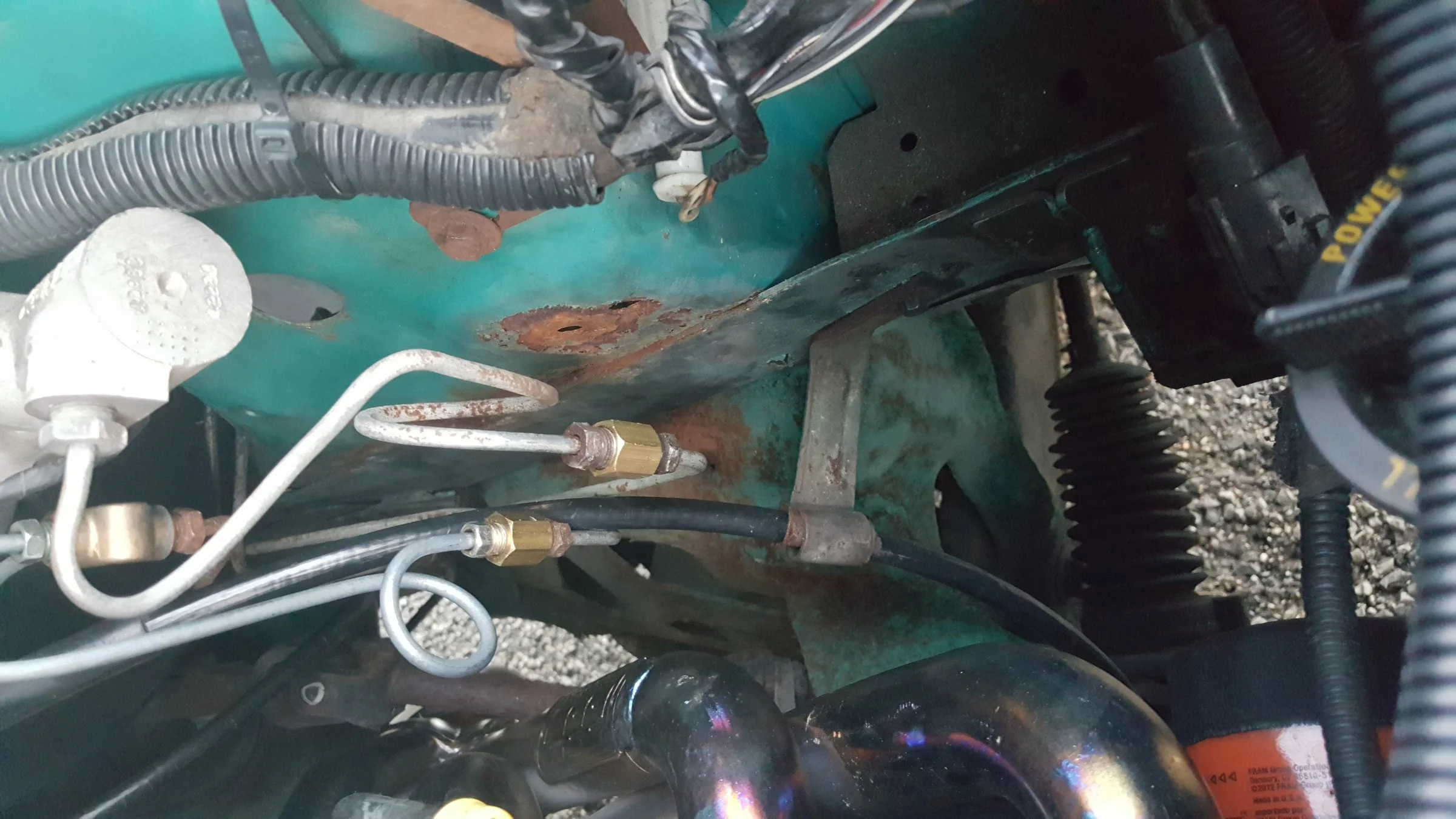

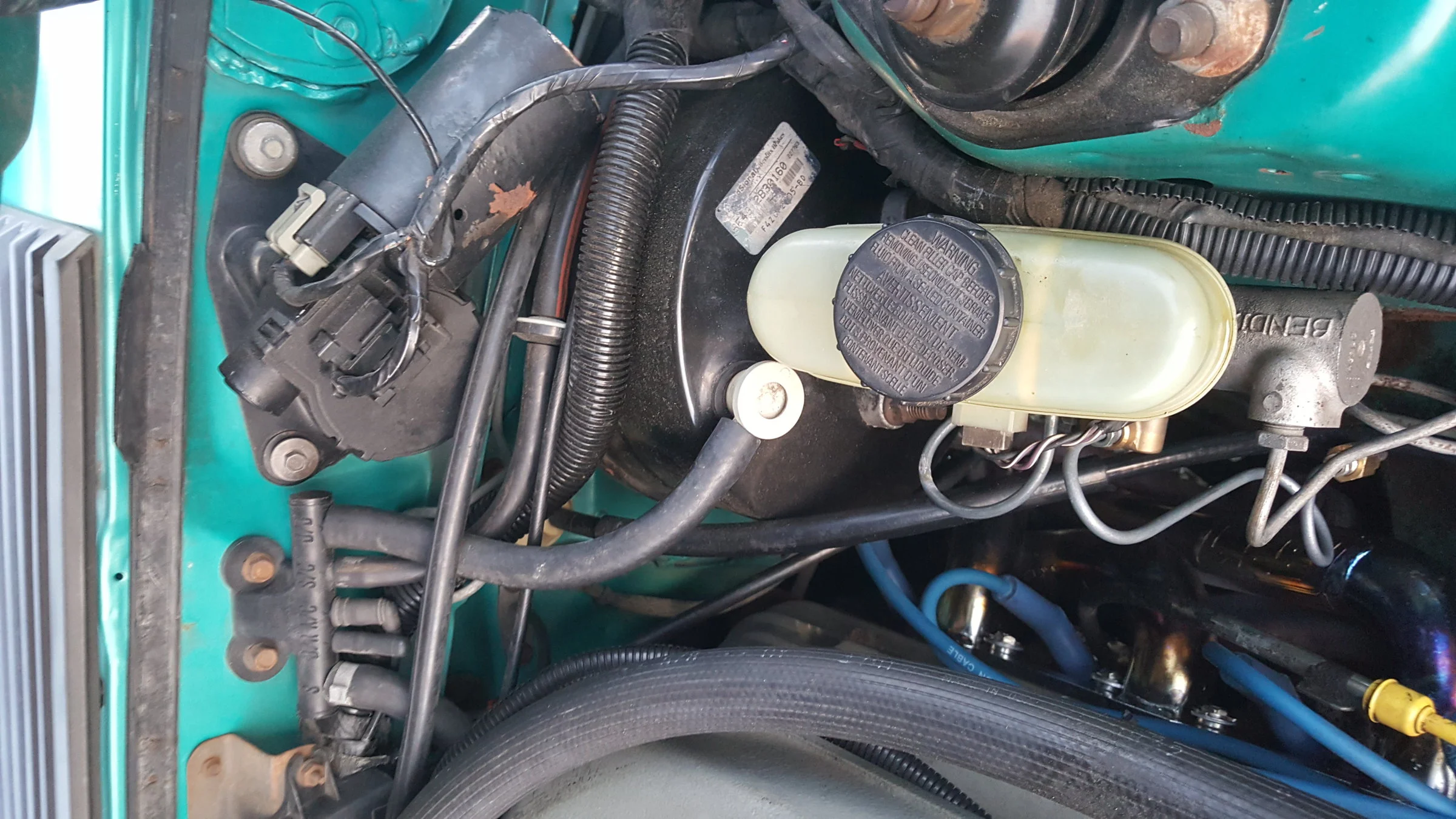

As for what booster to install. Let's see what you have right now. Can you take pic?

currently, I had these photos in my phone. I'm away from the car right now, but will try that out tomorrow.

BTW, your MC is a later model 2-port MC for rear disk brakes. Which one, I can't tell.
