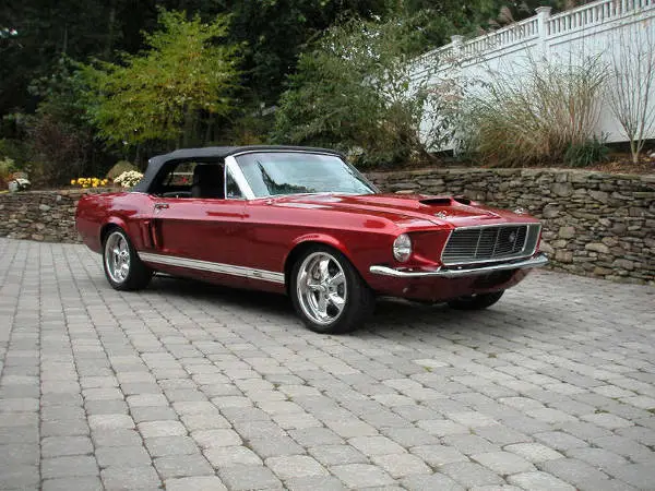

Feel free to check out my car at http://www.classic-mustang.net/jay though it's a bit outdated and does not cover the Flaming River R&P, the AOD, or the JBA / Borla exhaust I'm finishing this winter. Here's a quick picture too (not a jealousy issue on my side for sure):
