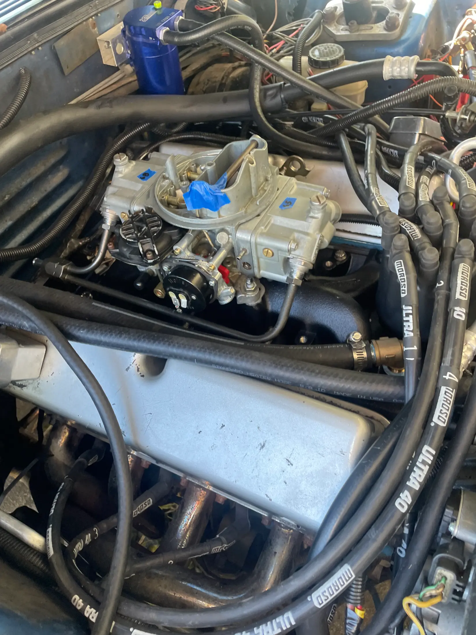

Engine Holley 4 barrel leaking at the carb manifold connections
What connections? Pictures are worth a 1000 words.
650. Holley street avenger 331 strokker. Big cam unknown, bbl long tube headers 3” custom exhaust
